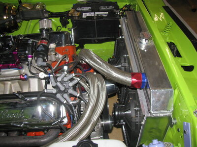

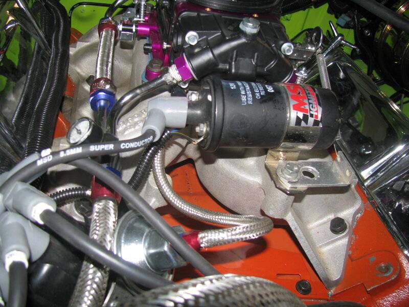

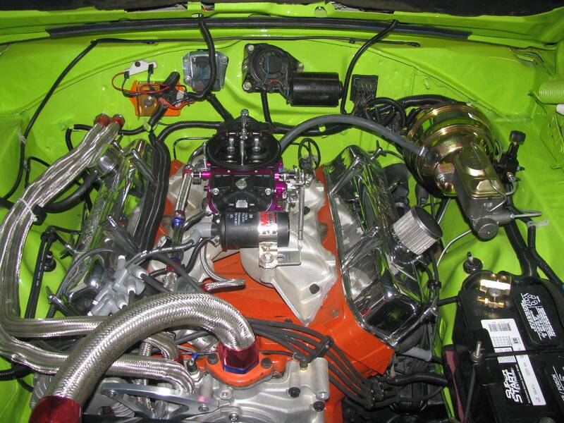

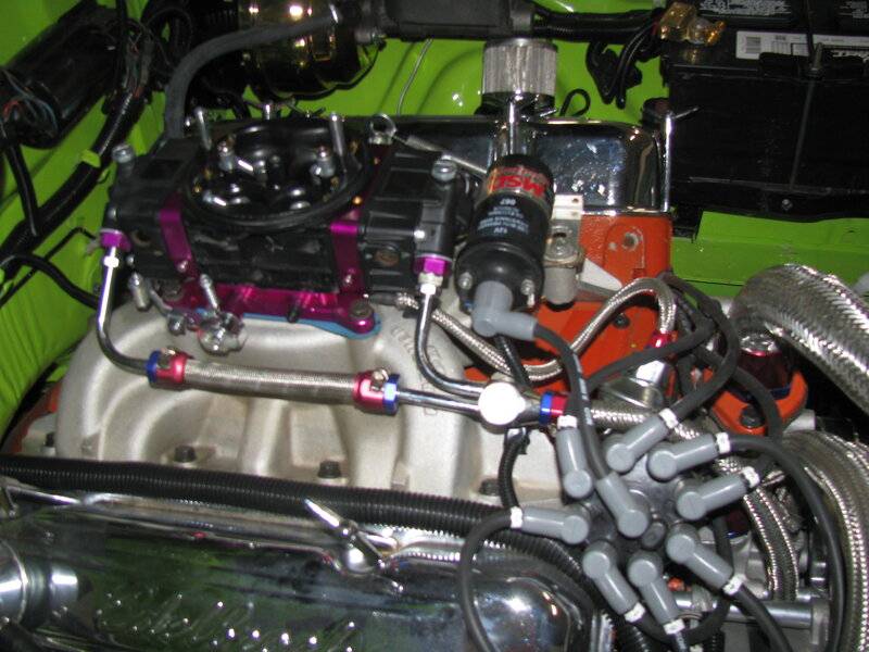

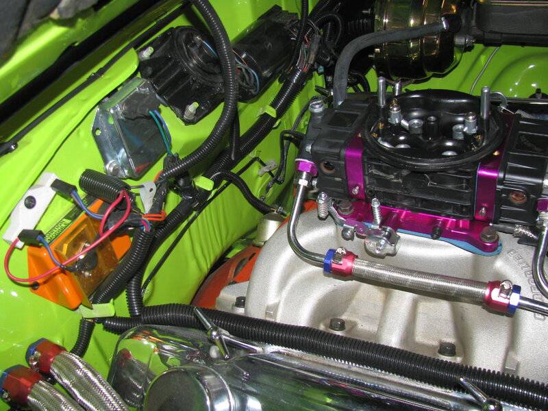

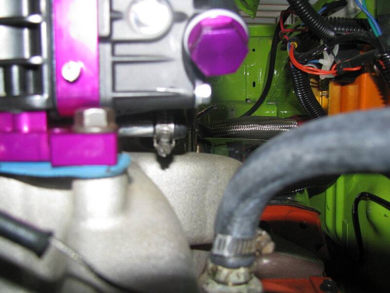

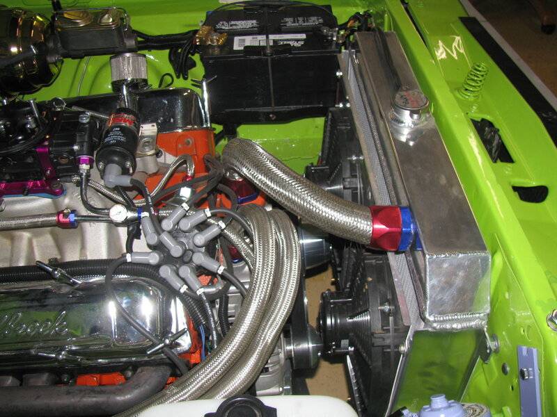

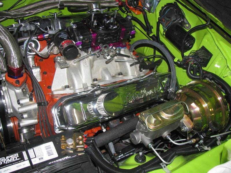

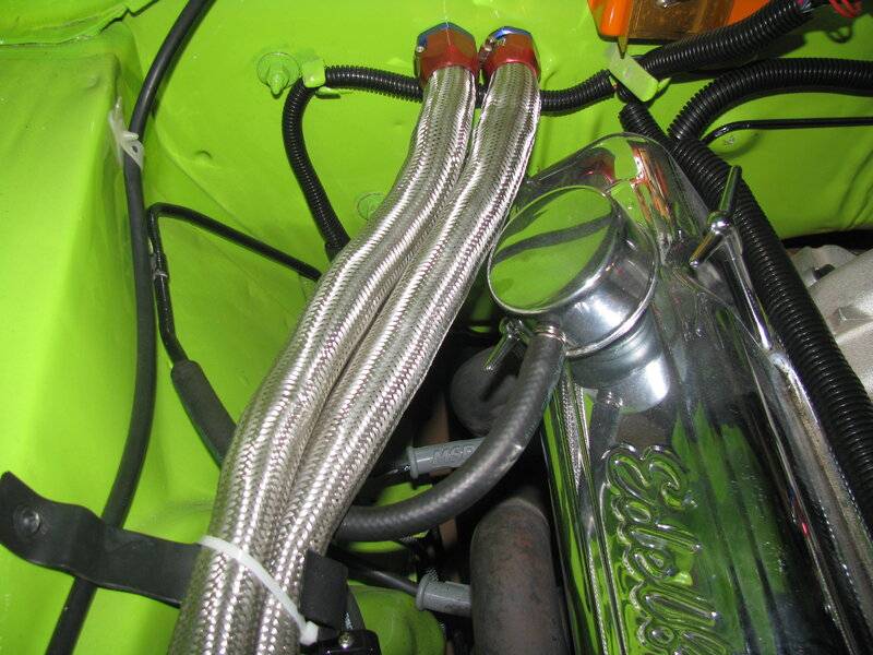

the engine is not stock I don't know much about it, edelbrock intake, brawler carb 750 double pump, electronic ignition, 10-1 flat pistons and a thump Cam and Lifters, Hydraulic Flat Tappet, Advertised Duration 295/312, Lift .507/.494, Chrysler, Big Block, Kit, I'm going to try some of your ideas and let you know what happens. I cleaned the carburetor, will check for vacuum leaks I'll send pictures to show what is hooked up to it.

Agree with that, better get one and install it because if you are setting the tune now you will have to do it again later on if you decide to install one...which is recommended to do.
