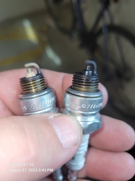

Pulled plugs and found one fouled. (Rear/passeger) Replaced that plug with a better but not new plug as I didnt have any on hand. Started it up after the plug swap and thought all would be good. Now the misfire has changed sounds from a subtle misfire to a full on backfire out the tailpipe. Any ideas on what to look into next? Cam lobe going flat? Sticking valve? I'm pretty frustrated....

I had a fouled plug like that this year. Moving the car too many times without letting it warm up. Used my IR gun and determined which cylinder it was. Removed the plug, cleaned it, reinstalled and alls well. Go figure.
the plug on the right looks oil fouled, so maybe a bad valve seal on that one cylinder? Maybe try one of those anti-foul things that screws over the electrode tip
Should be a 12 heat range for a Champion & 5 heat range for NGK.
