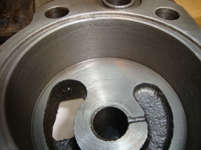

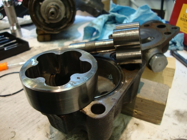

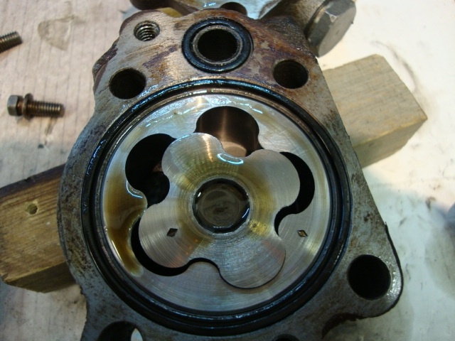

good time to check and make sure there is no scoring on the wall of the pump and the veins etc...
View attachment 405756 View attachment 405757 View attachment 405758
Thanks for the pictures , I see two Orings and a gasket to mate to block
