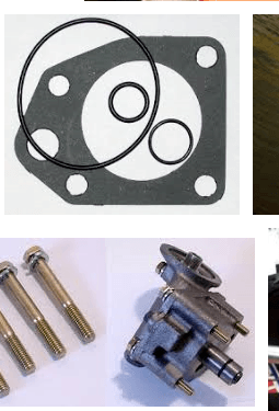

Yup did that learned that in high school - I'm also thinking of a low spot on mating seal surface but it's cleanNext time you have the filter off, look at the pump's sealing surface, where the filter seal sits. Could be some kind of defect, a low spot, or the like.
If you don't already, putting on a new filter, just a thin wipe of oil on the seal. Only need the exposed side done. That allows the seal to slip, while you tighten the filter, otherwise, the seal can grab, kink, and it will leak.
