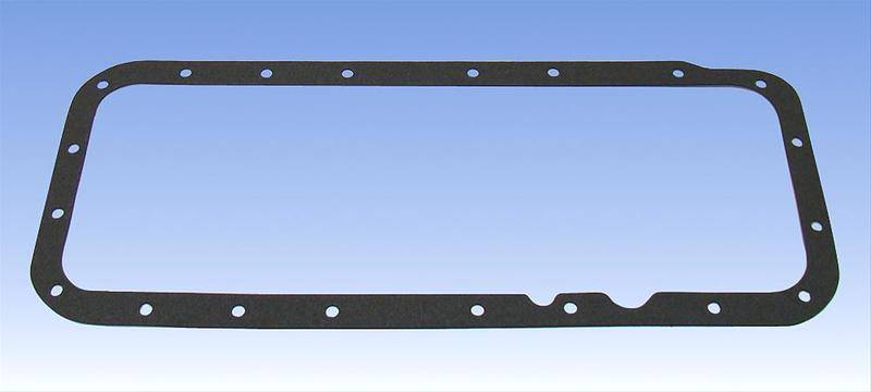

Since my ‘78 440 swap in December, the oil pan leaks like nobody’s business. I used the black composite gaskets that came with the windage tray and used aviation Permatex between layers. Fail.
Gonna change gaskets this weekend. I bought Felpro 1834’s with the metal center. Had good reviews online. Half the threads online said they used rtv between layers and the other half used none, both without leaks. What do you think? Dry or gooey? I’m also installing Milodon studs in lieu of bolts.

I bought the Milodon gaskets that are designed to not crush and squirm like cork. I used ultra grey between all the layers, but a very thing layer with my finger spread out...not a huge bead. I have a windage tray and zero leaks. I did not torque to spec because with that many layers the torque value will crush the gaskets.....just seat firmly and then just check once ran hot once.....no issues here.

The all-in-one gasket/windage tray seems to seal good for me. I have only used them on two engines so far, but they sealed very good.
Don't use RTV with that gasket/windage tray, it will eat into the seal built into the gasket.

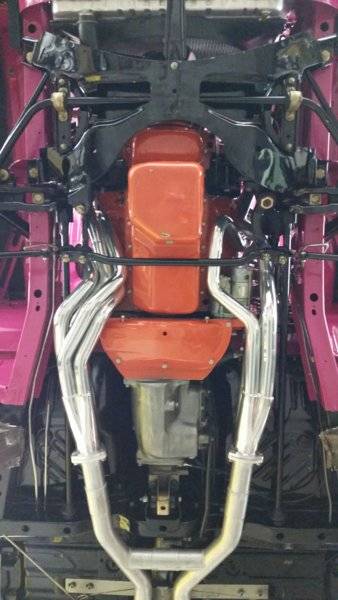

I use Ultra Grey RTV. But I also use a gasket. Why? Because with pure RTV getting the pan back off is a nightmare. The generic rubber coated black gaskets work fine. Absolutely no leaks if clean and used with good RTV . Even the tough small blocks seal. Here's one done 16 years ago.
Doug
I use Ultra Grey RTV. But I also use a gasket. Why? Because with pure RTV getting the pan back off is a nightmare.. View attachment 779967
Yes! Let the gasket tear and put a new one on. Much better than struggling to remove a pan and bending or gouging it up in the process..
