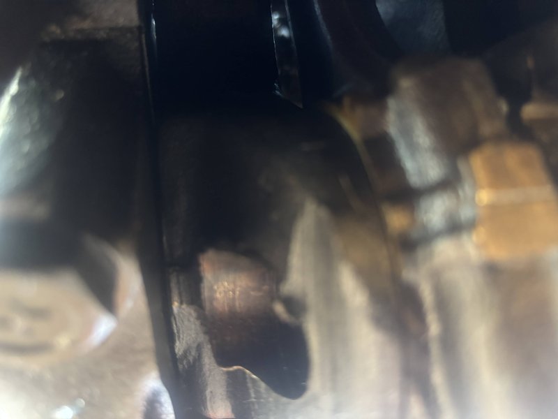

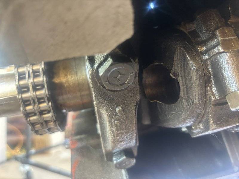

Hi Folks,
I bought a 440 short block, and I planned to install some heads and proceed from there.
However, I see this jagged metal “tunnel”. What exactly am I looking at, and is it acceptable?
Thank you
Here’s the pictures
That is part of the crank forging. No need to worry about it.

What cam and heads are you thinking of? And what is it going in? May be time for another thread!
as mentioned just normal factory sloppy casting. I personally try and take a die grinder and clean up and round over castings like that when I have an engine all apart helps relief stress risers in the part under load. Of course, I have been wrenching on cars for 50 years and have only seen a few cranks broken and they were all Chevy's never seen a Mopar crank break. Now the 440 blocks I have broken four of those.
I would not use a crank like that without cleaning it up. And I would be leary of the short block assembled by a builder that would not clean up that situation.

From the pictures I don't see it clear enough to say forged or cast, I never said it was a cast crank, I was referring to the manufacturing process that left the raw edges, those I remove when building an engine. And to get technical the only difference between a cast crank and a forged one is how the metal is treated, in the mold a cast crank is poured and in the forged the metal is hammered into the mold, while still elastic. The difference is the grain structure of the metal when finished. A cast crank has the grain structure in one direction in one direction a forged crank the grain structure follows the shape of the mold giving more strength.

Its still a forged crank in the pic, cast cranks would not leave an overhanging burr from drilling the throw for litening ..
