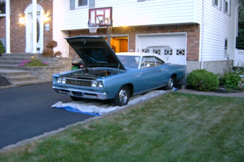

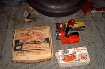

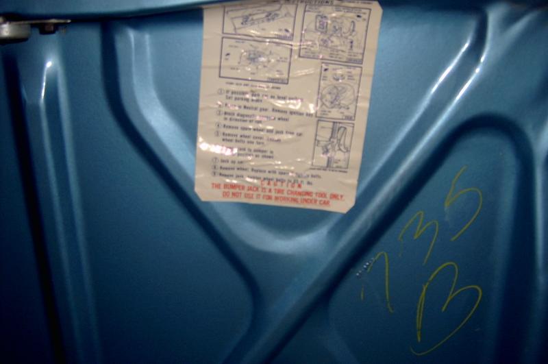

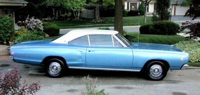

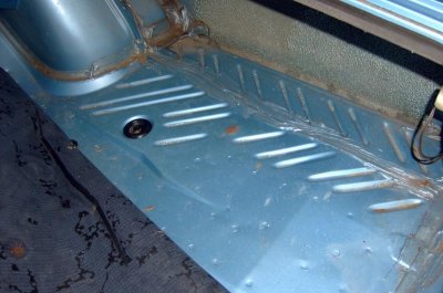

As promised a few pics of my car. I bought it last year from the nephew of the original owner. A really nice honest guy who also had all of his aunt's original documents in mint condition including the original bill fo sale etc etc. as you can see he even left the classic items in the trunk. A real time machine. I bought the car in New Jersey. Some of you guys may have seen it on the old ride website back when. It shows it's age up close but really incredible for an all original unmolested car. I drove it from New Jersey to my friends house just north of NYC. I returned a week later after US Customs cleared it for export and tuned it up and then drove it home (7.5hrs). In the pic the tarp was precautionary as my Buddy just had his driveway done but it was dry after a week. Again amazing given this car sat for 15yrs except being started and driven a few times around the block.
That's a nice looking car and a good find!
Thanks Meep Meep. the inside of the trunk photo is how I got it as well and as you can see really clean for a not ever having been touched. I really don't want to change it much outside of the powertrain upgrades etc. I will be making it my own to enjoy but being an older classic car guy I also like mostly original cars as well. The nice thing is lots of members here have posted their projects and some great ideas to help out.
