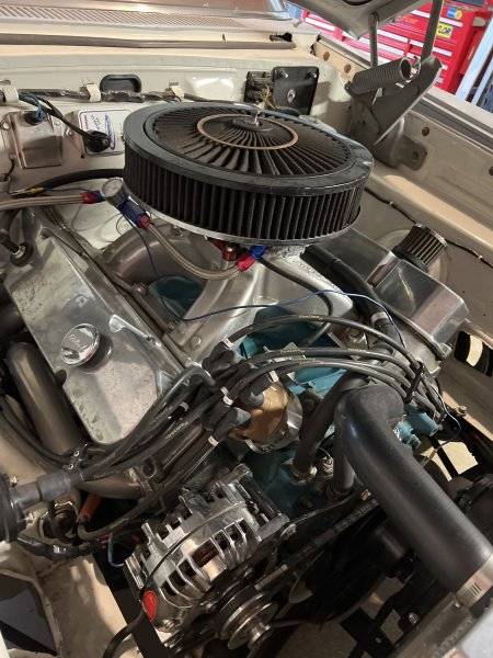

* 440/508 with Solid cam. Quick Fuel 950 Race. FBO Ignition Module. Firecore Distributor and Wires. New Plugs. *
I drove my car to work a while ago. On the way home, it was running fine. I stopped at the light, and felt like I lost a cylinder. My air fuel ratio went from 12.5:1 down to 10:1. I thought I must’ve burned to a plug wire. Drove it home on 7. Did find a suspect wire, and changed it, along with all spark plugs. No change.
* * When I crank the engine, it runs clean for 5-10 seconds, then starts missing (like a running on 6 or 7). IT DOES THIS EVERY TIME. Turn it off, fire it up, clean for 5-10, then rough.
AFR drops from 12-13 to 10.
I’ve checked every ground, and added grounds. I can’t find any arcing wires. Distributor cap “looks good”. I called 4 Seconds Flat and they suggested I cycle the rev limiter. No change. I’ve got 14.5 volts from the alt.
The fact that I can repeat this “ clean to rough” cycle over and over is what’s bugging me.
What do y'all think?
