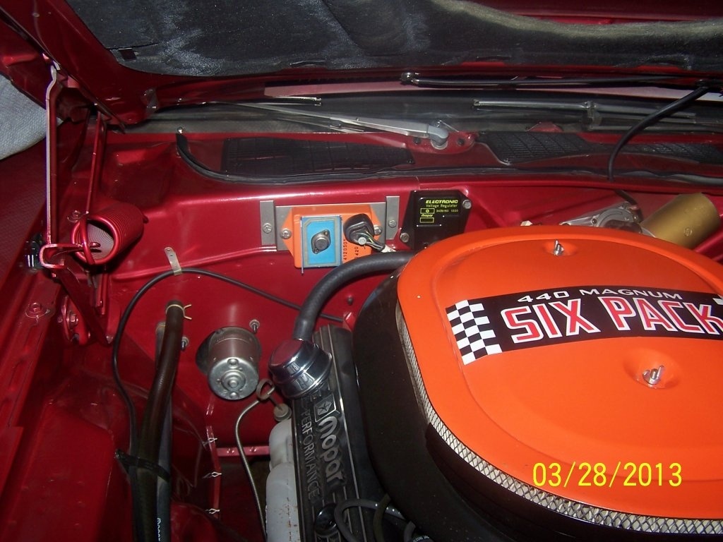

Sixpactogo where did you get that bracket for the orange box? seems that would aid in keeping it cool because its off the firewall.
The bracket on my Challenger came off of a 74 Challenger parts car I had. I think 71& up B & E bodies had them when they went to electronic ignition. I see someone on Ebay is selling them with the control box. I have seen them for sale elsewhere too a while back.
Here is a better pic of mine. Just a note. I know you said there was no corrosion behind your orange box but I didn't have any either. Just too much paint and the screws were not making good enough contact to ground. If you have a good ohm meter, test between the box and the negative post on your battery. You shouldn't see much more than .2 - .5 ohms. Another thing, your voltage regulator is not the problem if it is charging properly when running.
Thanks Sixpactogo, I will look for one. Someone told be Classic industries sells them as well brand new, but I will have to see which is cheaper, right now a friend has a car that he is parting it may have what i am looking for. I will keep you posted
If you can find a 71-75 A,B or C body, I think most of them had the bracket. I don't know how much they help with heat dissipation but they are easier on the threads in the firewall.
I mounted my ignition box near horns. use 3/4"x 1/8" steel strip bend so it was 2" out to clear horns. had to be a little creative not to drill any holes but it was bolt on.
