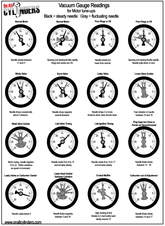

Maaybe this will point you in the right direction..your readings will obviously be lower but this shows how different things affect the gauge behavior..
