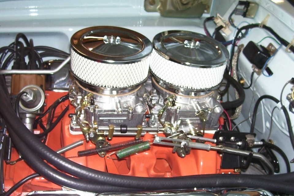

Well its almost time to test out new the six pack at the drag strip. Wednesday May 4th at Thunder Mountain (Bandimere) will be the big day. Previous best was 13.30 @ 100 MPH with a Performer RPM and a Holley 780. So I will post the results here shortly after the test session. No other changes have been made other than a valve adjustment. Just installed a new six pack set up with new carbs, linkage, intake. I will be using the same slicks as last year. I hope it goes faster!
Can't wait to see your time slips. I did the same thing years back but never went to the drag strip again so I don't know what the time improvement was. I can tell you my street racing experience was significant.
Now it's running consistent 12.90s @ 105. Improvement of .4 sec and 5 MPH with the six pack installed. Not bad for 5600 feet.
Sweet move. I wonder how much the altitude impedes performance. I wonder what you'd get at sea level.
I think sea level will get .8 sec better E Ts. The wallace calculator indicates a Horse power correction factor of 1.29. Then using this factor it calculates a sea level ET of 11.85@114. The high altitude really reduces performance on a normally aspirated engine.

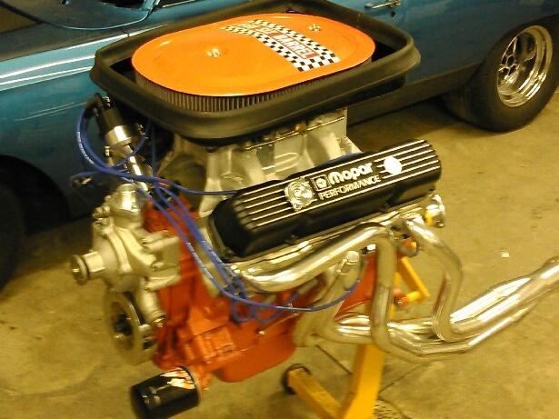

My target for a stroker motor is mid 600s HP and Torque. I have 3 builders that I have narrowed my choices to including Mike of MRL. I have seen that they have dynoed 6 bbl motors and am sure they can get it done. At least one of them has some 6 bbl intake massaging capability. Also, most of the car's duty is car shows and crusing, although I'm sure that its time at the track will increase after the new mill goes in :) point being that the low and mid range torque and "driveability" of the 6 bbl intake is as important as the ultimate HP capability.
I had Jim @ LaRoy engines do mine. 9.9:1 trick flow heads and a mild solid roller cam. 590HP
