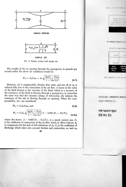

Bob likes to baffle us with his BS, but anybody can pluck that info from the net....or a book. Below is from Larew's Carburetion book......
