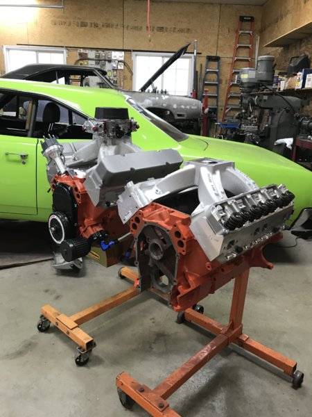

Little brother 240 combo next to the big boy 270 setup.

The modman in 3x2 form would be an interesting twist on top of a 270 head stroker.
The only reason why I mention the ModMan is it appears to be a "direct flow" straight runner design single plane manifold that can accommodate a 3x2, but I am not aware of any "glowing" reviews of it for performance w/the 3x2 top plate. If anyone has links to any articles reporting success w/that configuration I'd love to see them.
The Weiand 3x2 intake always intrigued me, but OMG there are so many tweaks required to get it to work reasonably well I'm surprised it was ever marketed, and it won't work with the N96.
I do believe hogging out the ports on the ModMan to TF270/Max Wedge size would be easily accomplished too.
From what I’ve heard the mod man works decent with a pair of 4 barrels. If you use a single 4 though you leave lots on the table. I’d assume the 3/2 setup may be decent. But who knows.
