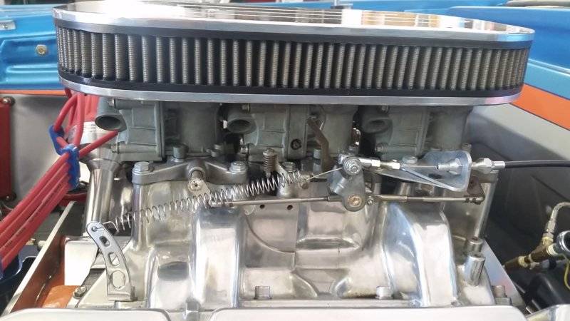

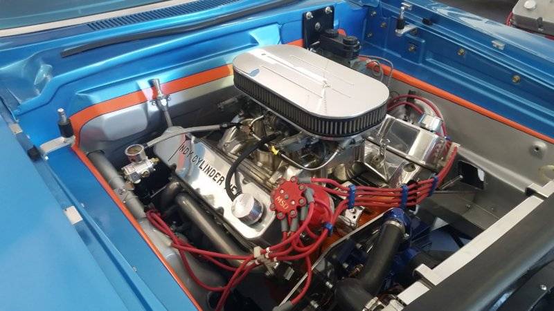

This is the 3x2 6 pack setup on my new 65 Belvedere. It has the aluminum intake manifold supplied to Chrysler in 1969 before Chrysler switched to the iron intake manifold in 1970 to save on cost.Being as I have decided without a doubt nor open to debate that a 3x2 intake MUST sit atop my next motor, just like the engine in it now and the day it left the factory, because I want to honor the fact that my Roadrunner is a real V-code car and 3x2 setups put out great HP and torque even compared to modern designs, and look really cool.....
Given all of that, the Chrysler/Edelbrock 6bbl intake I have now is a dual plane so that isn't complimentary to a high RPM engine.
I'd consider the ModMan intake with the 3x2 top plate, but I'm very skeptical about the performance of the ModMan and I also want the intake to work with the N96 hood and airbox.

Hey Mike. How does the six pack work on the 240 head? Have you dyno’d it or run it at the track?This is the 3x2 6 pack setup on my new 65 Belvedere. It has the aluminum intake manifold supplied to Chrysler in 1969 before Chrysler switched to the iron intake manifold in 1970 to save on cost.
I’m pretty sure mikes new motor has Indy heads on it not the 240sHey Mike. How does the six pack work on the 240 head? Have you dyno’d it or run it at the track?
I have a 6bbl on my 440 TF240 with a 238/242 @ .050 .620ish lift cam 9.9:1 compression with 91 octane gas it made 590 hp 550 tq.
