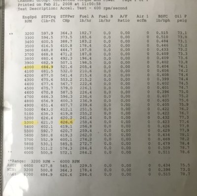

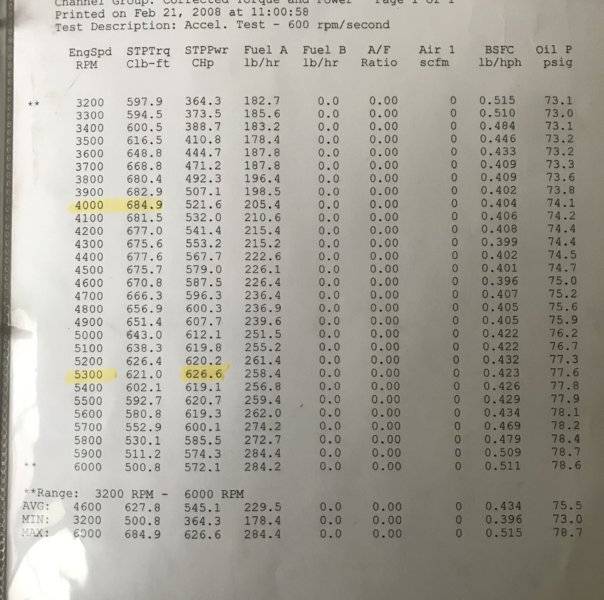

3,400 to 5,400 RPMs 550ft/lb That's nice!
:thumbsup: :lowdown: IQ52

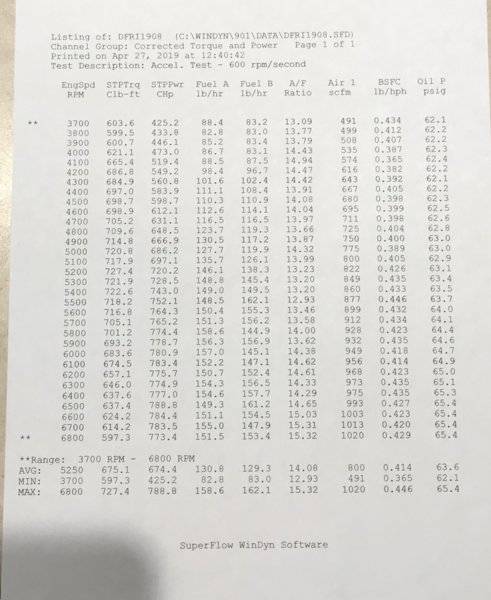

I've seen some 6bbl RB stroker sheets in the 650 ft/lbs+ range, and close to 600HP.
I did this one with a small hydraulic roller cam a decade ago. With the 240 heads and a bigger camshaft, it’d easily make 675+ and still push 685 ft/lbs.

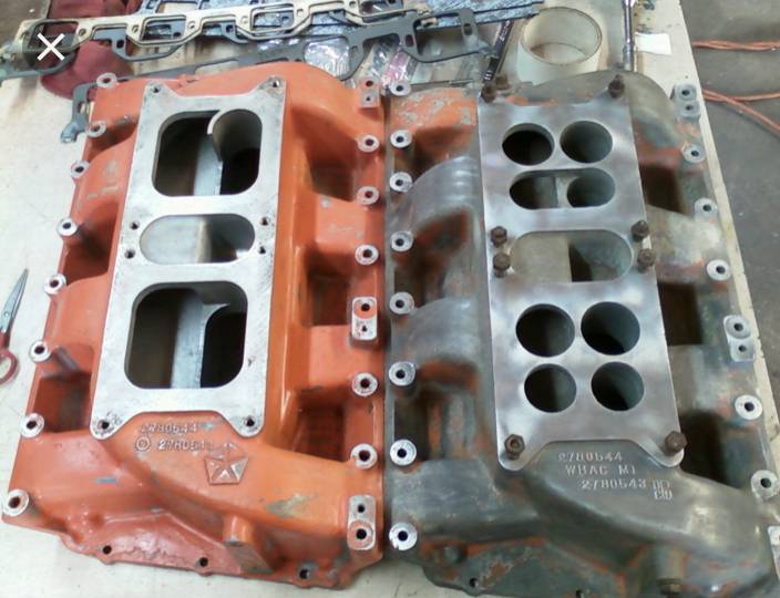

A 6 BBL with some tuning will give you power. Modern heads & cams will get you 600+ HP. The A12 manifold may not be the greatest, but it will really work to 6500 RPM. Good luck.
I would preface that last statement with “Below 450 cubic inches”...
I guess I agree, 446 or 452 works for a dual plane manifold.
I know :lowdown:Jim LaRoy did some ~500+ cu in stroker motors with the factory 6bbl.

That’s not hard to do with 500” and the 240 head.
Big motors want more air. The stock 6 BBL manifold is good at 450 ish cubes. Don't think it does the job at 500+. INHO
500 cubes defiantly starts to test the limits of the 6 pack. My experience is they still make good power. ET wise I didn’t see much if any difference between the 6 pack and a TM6 with a 1050/4150. Granted I would be curious to test a modern single plane. Where mine suffers is it has poor distribution under cruise. I also found I had to run the tune up a bit fat to keep the idle happy. The single plane is way happier at idle and you can lean it out without any adverse affects. There is a modification that can be done on the six pack called the Vanke modification. I plan to do that to mine before or when I go back to the six pack. Right now though the Dominator would be hard to beat. It does it all!
