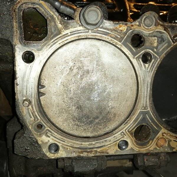

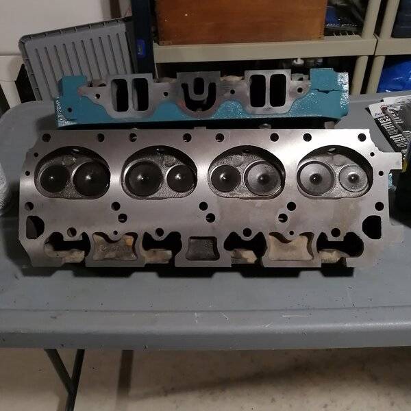

I just had the 516's on my 66 361 redone. We cut them .020 and cc'd them. They came in at 75cc's. The pistons were .065 below deck. I used a .040 composition head gasket and compression came in right at 8.5:1. The last set of 452's I had were almost 90cc's. That would severely drop your compression ratio.
