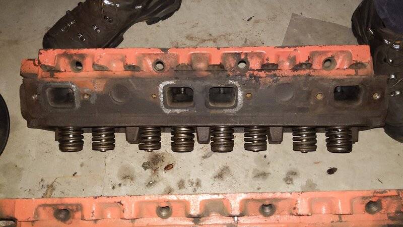

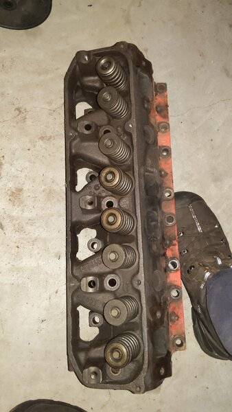

Recently i picked up a set of 452 heads and i noticed the valve springs on the exhaust side have different springs and retainers than the intake side. Im still learning so bear with me here. If im looking to to get new springs how should i go about this. new aftermarket or new stock ones its one a 400 78 cordoba lean burn delete, kiethblack pistons with valve relief. and its gonna have a stock roadrunner cam just looking for a cruiser nothing crazy. part numbers of springs would be awesome thanks!
The shorter exhaust valve spring are usually to compensate for the larger "Rotator" valve spring retainer. If you get new springs, get the matching valve spring retainer set which would eliminate the exhaust rotators. I have never seen BB Mopar heads with rotators that I can remember, so I had to search images, and found one pic. It doesn't look stock and the exhaust springs look to be conical, like someone was trying to make them rotators. The funny thing is, all normal Mopar exhaust valves with 4 keeper grooves, wait for it....... MAKES them rotate already. The only reason for rotation is to prevent deposits from keeping the valves open and burning. On a side note, if you rebuild you heads, all of the keepers should be replaced, especially the exhaust 4 groove keepers. There is a lot of wear in the keeper and valve grooves if you check. Back in the day, replacement valves included new keepers with exhaust valves.

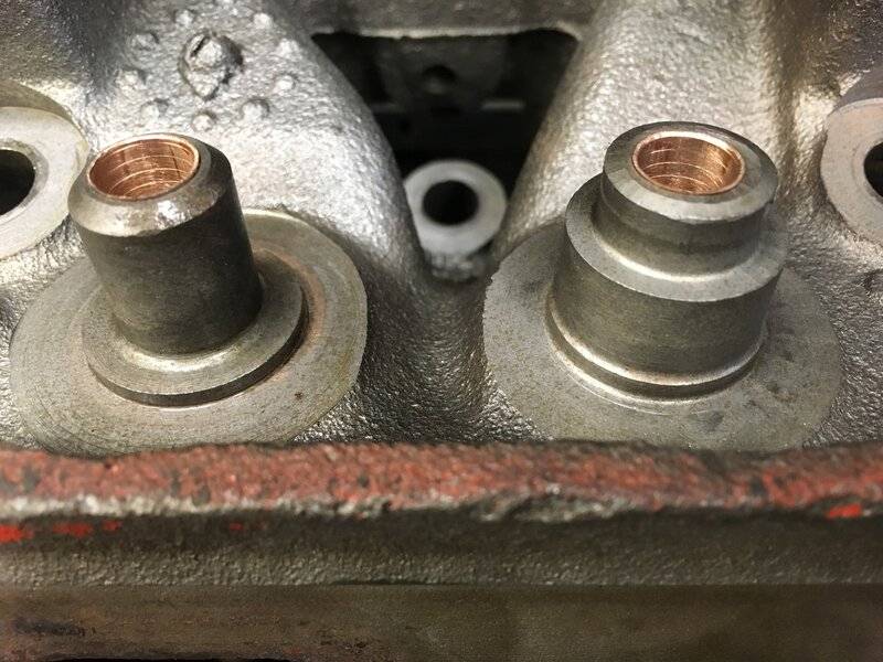

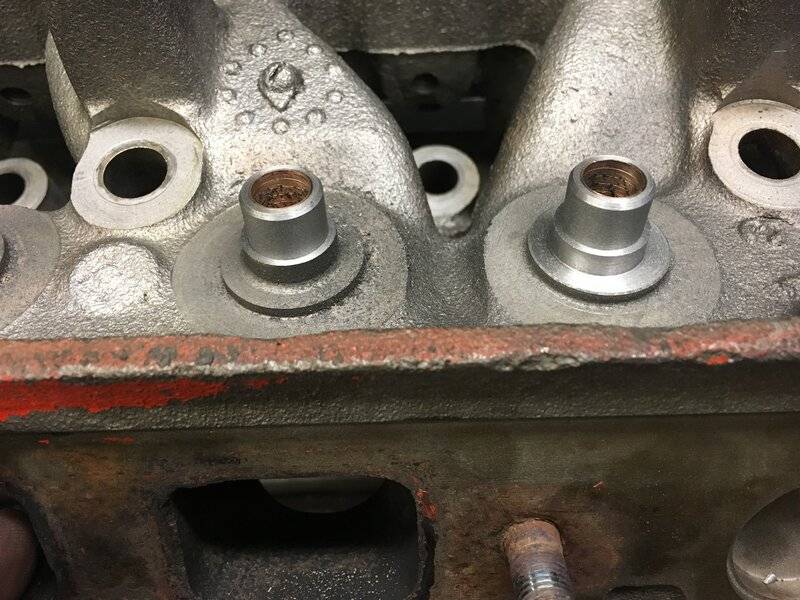

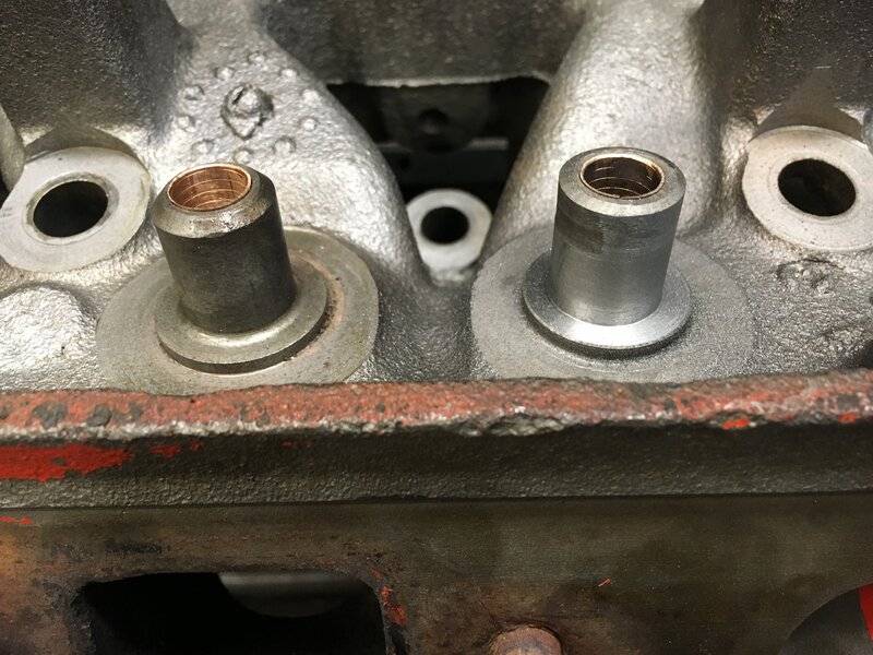

96F70C92-3273-4998-A08C-FA1105F3EABF.jpeg 585E4BA1-87B3-437D-8692-8F39C2B1CAA6.jpeg 04B7D4F3-2C47-412A-BD9F-67C3FCF11560.jpeg
My guess is if you pulled off one of those ex rotators, you’d find a two groove valve.
Then, you could pull the valve out and see if the stem was 3/8” or 7/16”.
The 7/16” stem valves are normally sodium filled(they will still be 3/8” at the top).
Motor homes and industrial engines may have , I wouldn’t put it past Chrysler engineering..Someone will chime in
Late update the intake has positive valve seals and the exhaust has umbrella and they are all two groove valves
