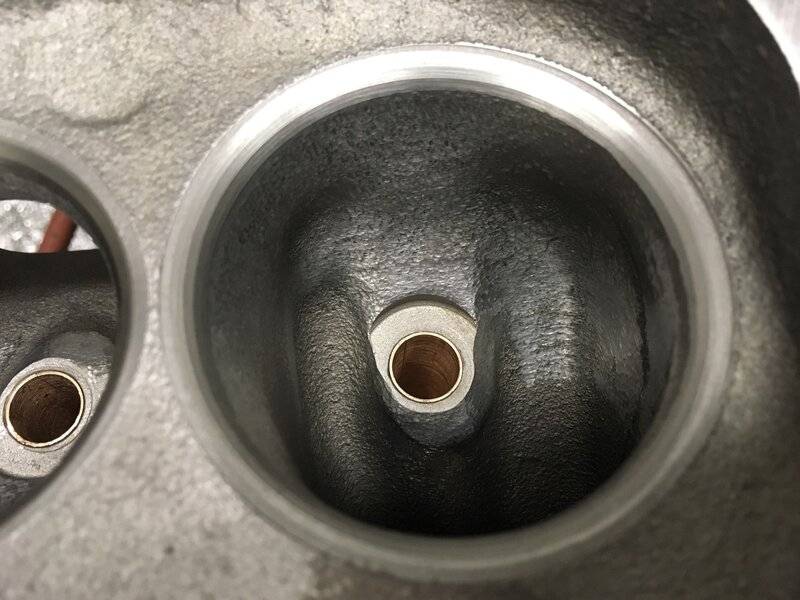

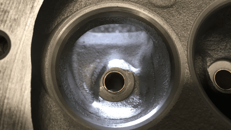

IMHO a 6-8 CC gain is worth it on a 452. They probably started in the 88-90 ish range. A deep cut valve job to remove the ridge under the seat does wonders.

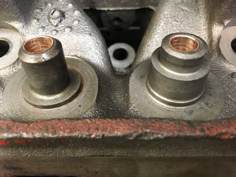

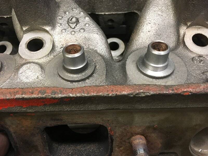

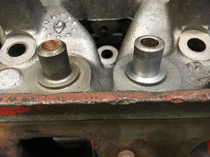

One thing that generally needs to be addressed on 452 heads if you’re planing on using a cam with near .500 lift is shortening the guide bosses.
Also, if the heads are set up with exhaust rotators(which many MH 440’s are), then those need to go, along with the 2 groove exhaust valves........ to facilitate the use of springs suitable to accommodate the new cam.
This is how I handle the guide boss situation......
