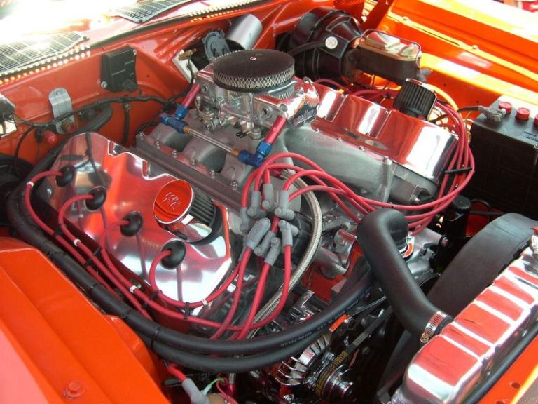

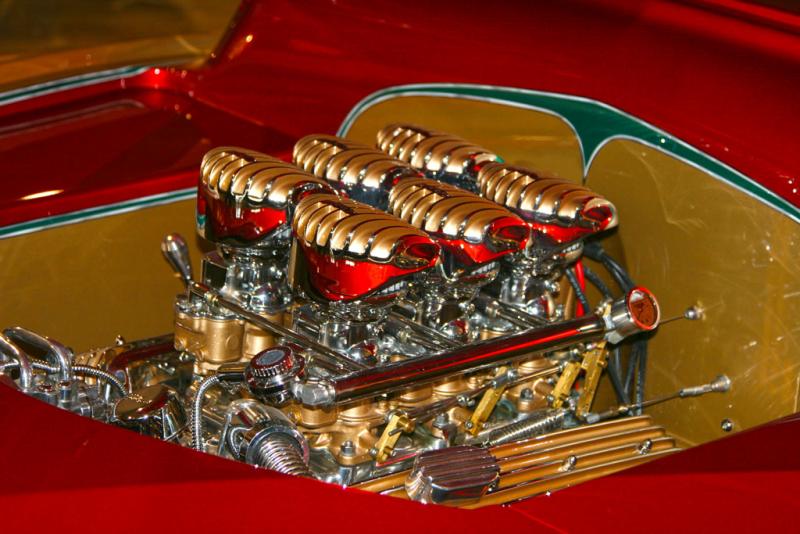

But for sheer visual appeal, nothing beats a six pack or a multi carbed Hemi (especially at a show). EVERYBODY loves them!!
Ah you forgot about this for awesome visual effect ! Ron

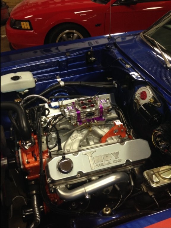

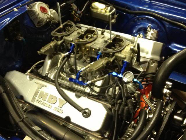

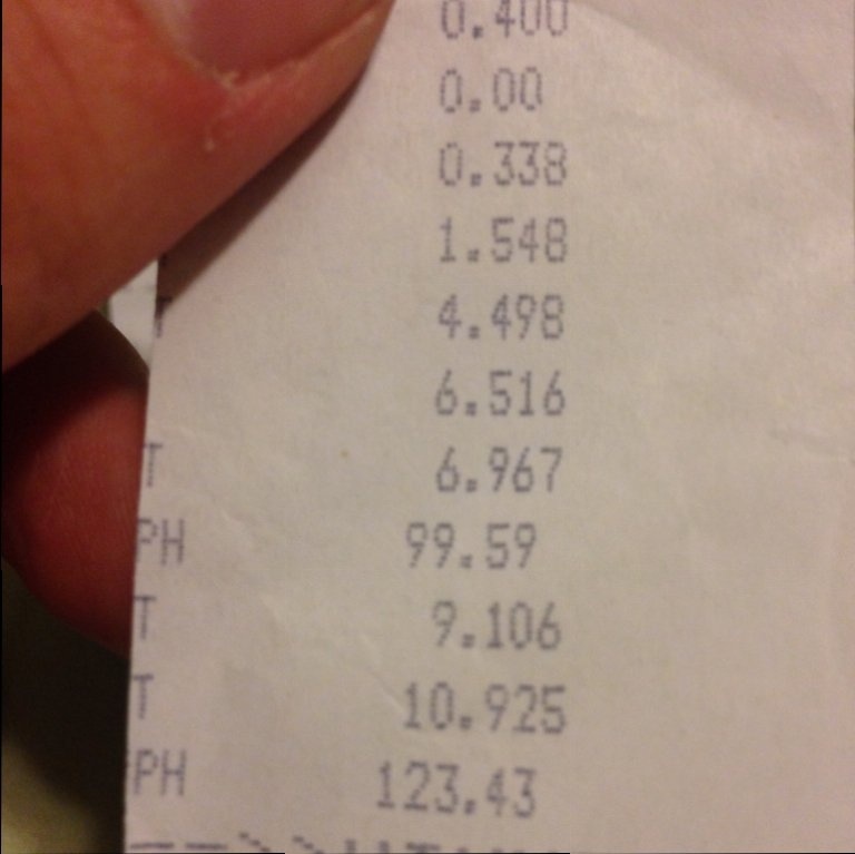

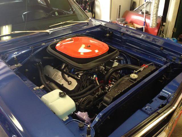

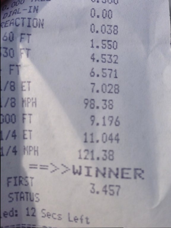

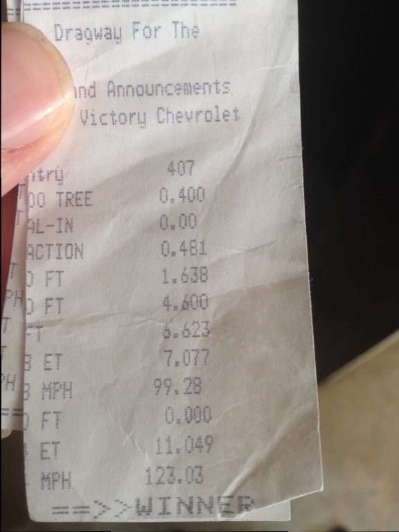

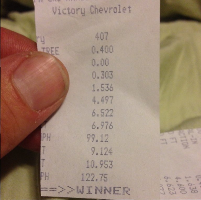

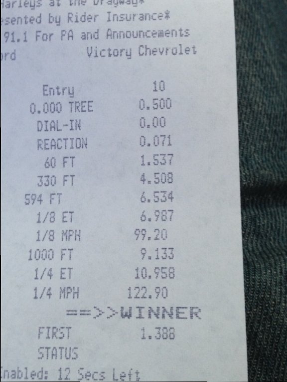

Just for some fun info. Different days, both decent weather. 2 full runs with six pack. 3 full runs with 4 barrel. This is on a 4000# (with me) street car. No other changes. Drove both setups to the track.
Six pack 500cfm center
1050an carb, tm6, 1" open spacer
