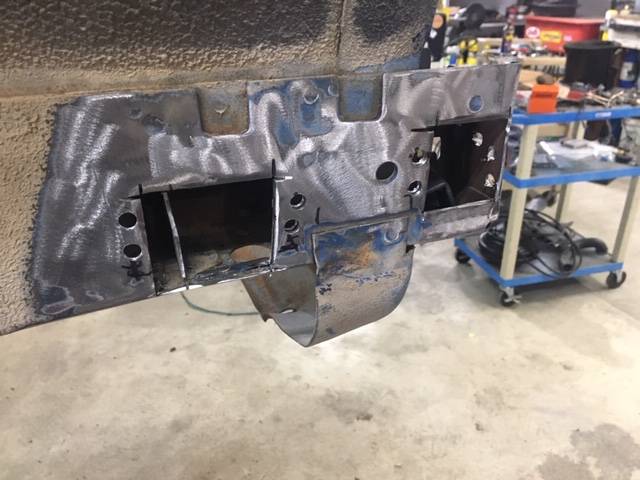

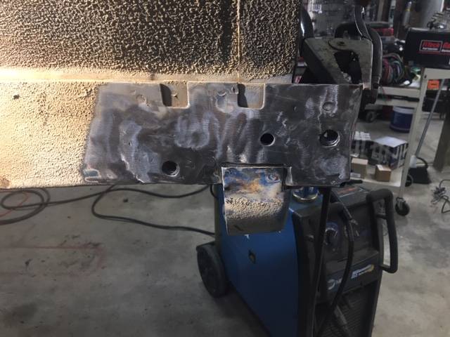

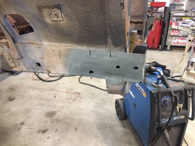

I already had to work on it, had to fix the 1/2-20 threaded inserts for the front bumper on the passenger side, one was missing and one was trashed.
