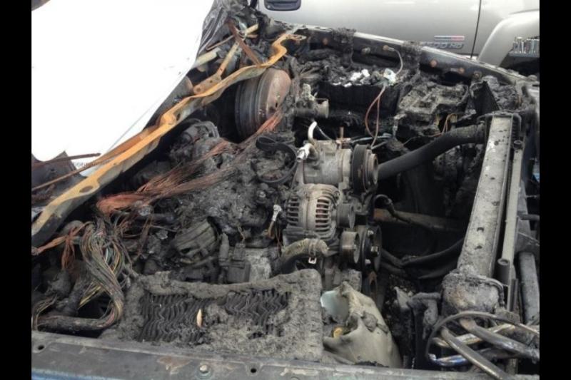

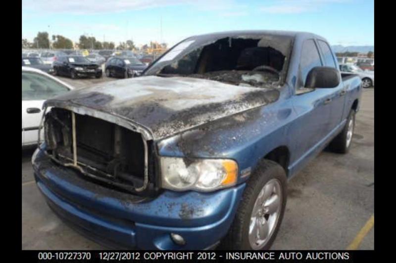

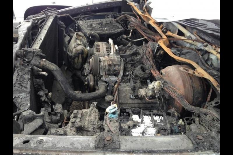

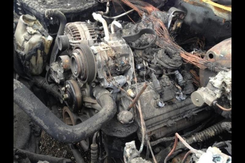

I been looking for a cheap engine to build along with my car. So I found a 03 5.7 but was involved in a truck fire. It looks like from the picture the intake is melted and some other stuff is no good. But I'm lookin for block, heads, timing cover basic stuff. Plan on rebuilding any engine I find with all new internals. I offered 500 for engine and transmission. I'm already assuming that every thing on the out is trash. But if any thing else maybe works as a core for another engine off eBay

Just a FYI heads are aluminum and most companies included us see cores that are sent to us for exchange show any fire damage or warping we will not accept them.

Just stay away from fire vehicles...not much to get out of that thing but scrap value.

A burn engine is worth nothing. then add that it is aluminum, 90 percent chance everything is junk. Stay away!
The block is cast iron. Only the heads are aluminium. Only the block is probably still good. Heads could be, but there might be some warping. As it is, thats probably worth no more than 200 bucks, just for the block.
