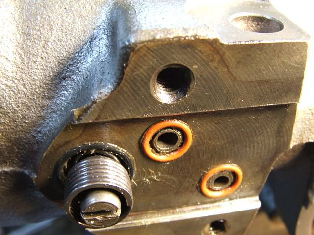

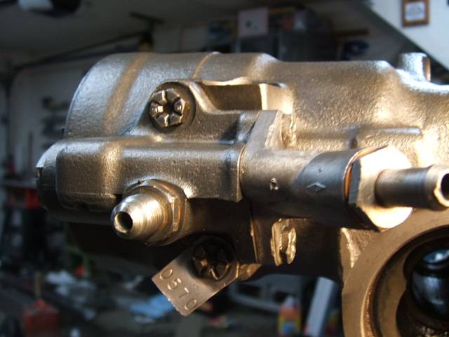

The power steering box I purchased from Yearone so long ago I can't remember. It's a stock replacement for my 68 Charger, thing is when I fire up the engine the unit wants to turn the wheels to the right. I went thru the bleeding process several times but it still wants to spin the wheels to the right...any suggestions?
The re-manufacturer tech didn't adjust it right. If you don't know how to adjust it, you need to break out the FSM. (Factory Service Manual) It is clearly explained how to do it. Piece of cake I might add.
Loosen the two bolts slightly and slide up or down. Be careful when you start it. Too far one way and it will snap to that side taking you hands with it!
