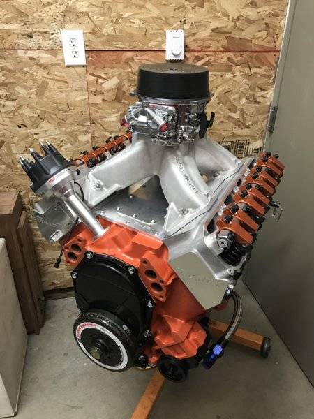

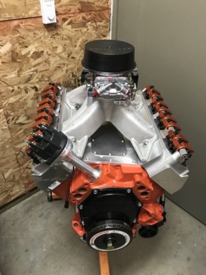

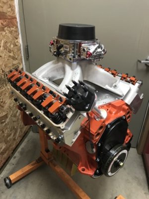

Waiting for plugs, wires and pushrods.
048909A3-4554-46AD-A5B5-5937B2DE79B0.jpeg 100CB1C3-17D7-47D1-BF84-F175F568E09A.jpeg 5D7222EC-3F06-4AEA-A6C2-BC2769A9D363.jpeg
I have the same carb on my 512. Is that a 4710?
Drilled out the big transfer slot restrictions, tapped them for 10-32 set screws and shrunk them down. Went down to 2 emulsion holes on the blocks. Moved the IFR’s to the bottom of the blocks. A few small changes on the air bleeds. I have it all written down. I can send you a pic of the tune up tomorrow if you’re interested. Really cleaned it up and made a nice running carb.
Yeah I’ll PM you my phone number

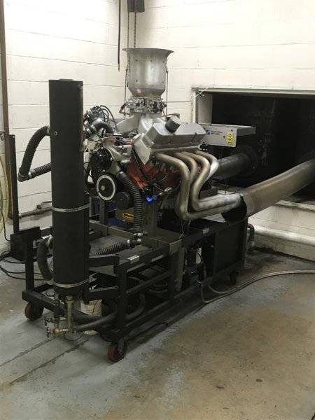

I have an AED as well that I dyno’d the motor with originally. It has just been rebuilt since the dyno. Figure I will save it for the 572.
This 4710 is the carb I used when I used to run spray. It’s been a decent carb. Will see how it is in a couple weeks.
