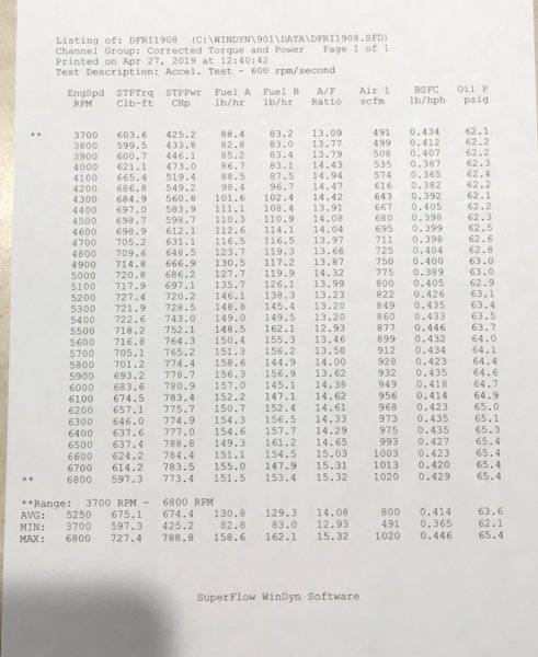

Hemirunner
Yeah you nailed it! I read through a lot of Andy’s tech articles while working with these heads. His 470 went 1.597hp/cube with similar compression and a dry sump illustrating the potential of these heads so our 1.553hp/cube is in the ball park but shows areas for improvement. I could have bolted on a vacuum pump and seen a slight improvement but it isn’t gonna be ran that way in the car so it was a mute point.I was very close on my guess. Hemirunner and I were chatting before the dyno results. Originally I guessed 820’s because I thought it was a 13-1 motor. But when he told me the CR I guessed high 780’s-low 790’s. I was pretty close. Very impressive time bomb build LOL.
