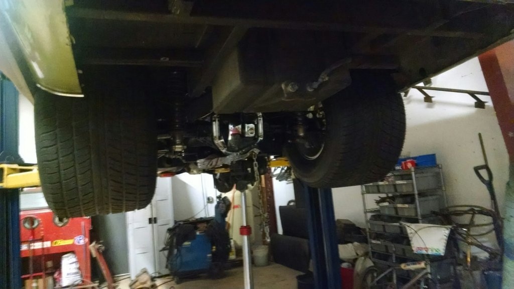

The owner of this build got the car going.
Another friend of mine went for a ride today. When the outboards come in at highway speeds, it blacktracks the road. I bet it's loads of fun!
