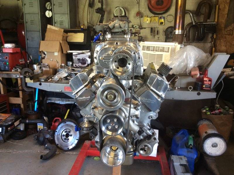

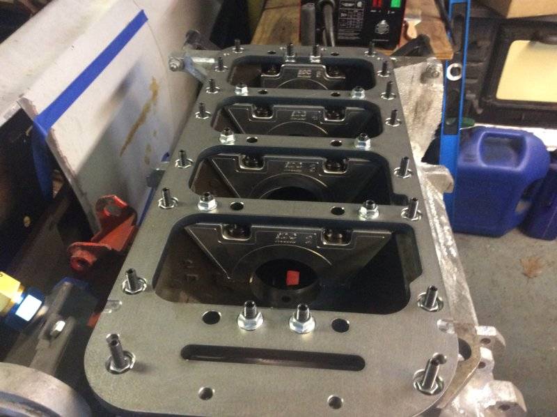

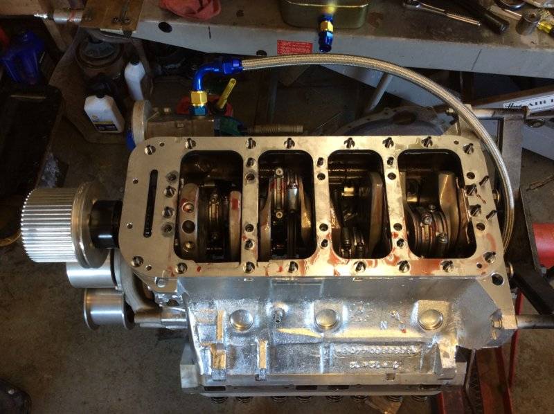

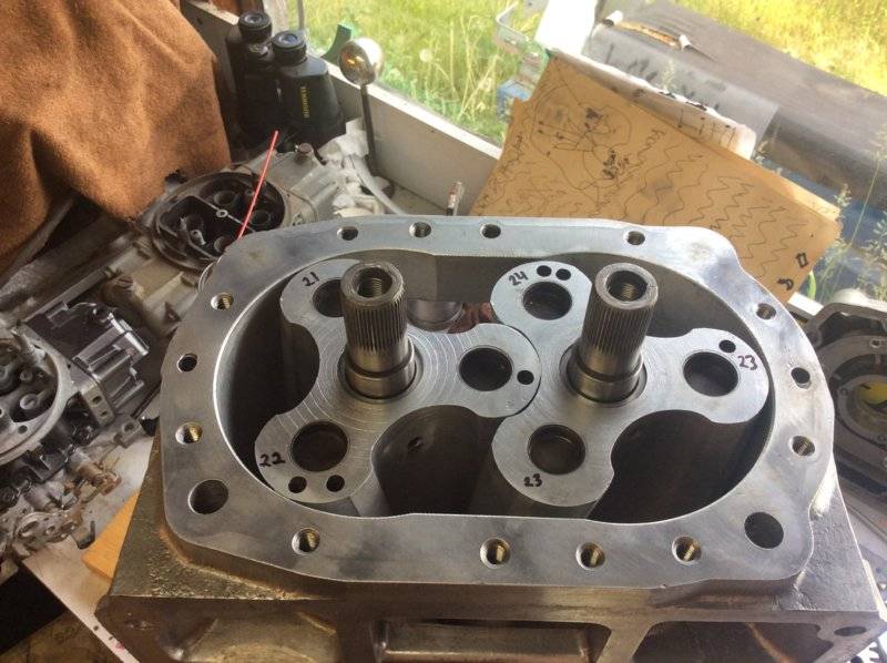

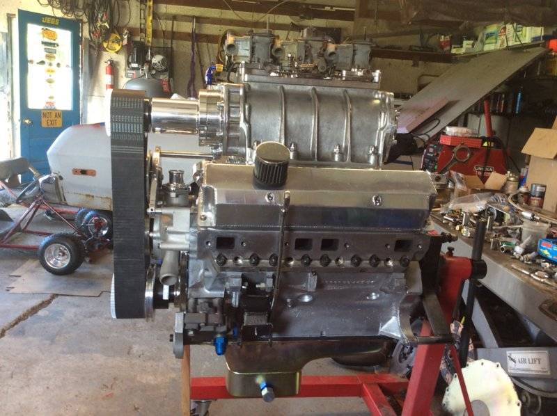

it’s almost ready!
37458828-4937-4A3C-AE28-A6F2E2E24936.jpeg A1BEE6B1-63C9-48B1-B4EE-65C009C280DD.jpeg 6DFD8DB8-EE8D-4F23-BB87-7ED8D4AED2F3.jpeg F5E79881-DA27-4959-9F05-6C256AE090EF.jpeg 656A2EB4-8E55-4328-896C-1F00B15C3295.jpeg
Never a such thing as to much power. That's what they make the skinny pedal for. But.... That's prolly going to be just about enough.

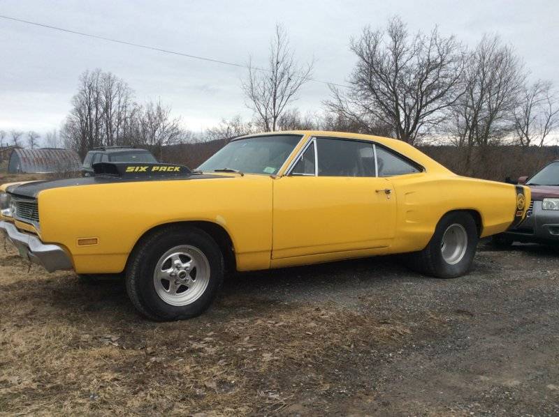

It’s going into my 1969 super bee, pro street 4 speed narrowed Dana w 488s, the tires are 31x18.50-15s, super stock leaf spring car.
C7C585BB-290E-4F9E-8FE3-511D32A2CDBB.jpeg C8046EFE-0409-472C-8948-96BFAB2F18C4.jpeg 0AF45F6E-1F3D-44E8-8C5A-C652BD71AEB1.jpeg

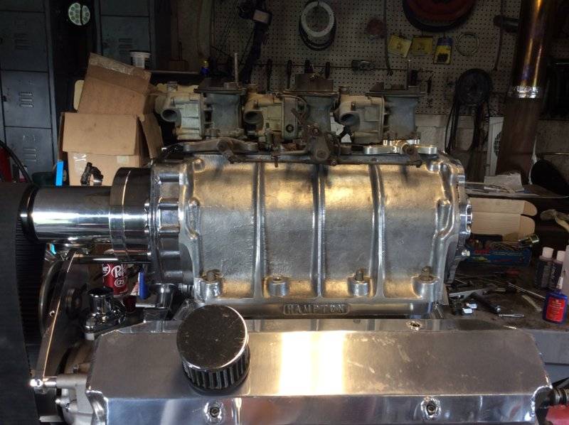

I will try to use the six pack hood but I don’t think it’ll fit under it, I’ll probably run with no hood and a modified hillborn style aluminum scoop,

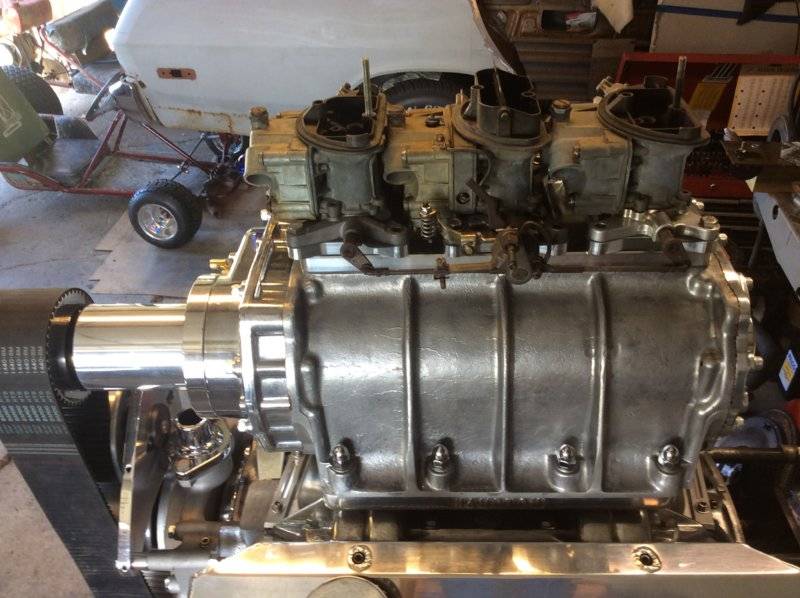

Nice! Old Style Roots Blower... Set up a few back in the day.... Personally I'd run a flat hood cut for clearance with the scoop poking wayyyyy
out....
I do have 2 spare hoods uncut, i have to make a template for the opening, I need to get the engine installed and see what I need to do afterwards.

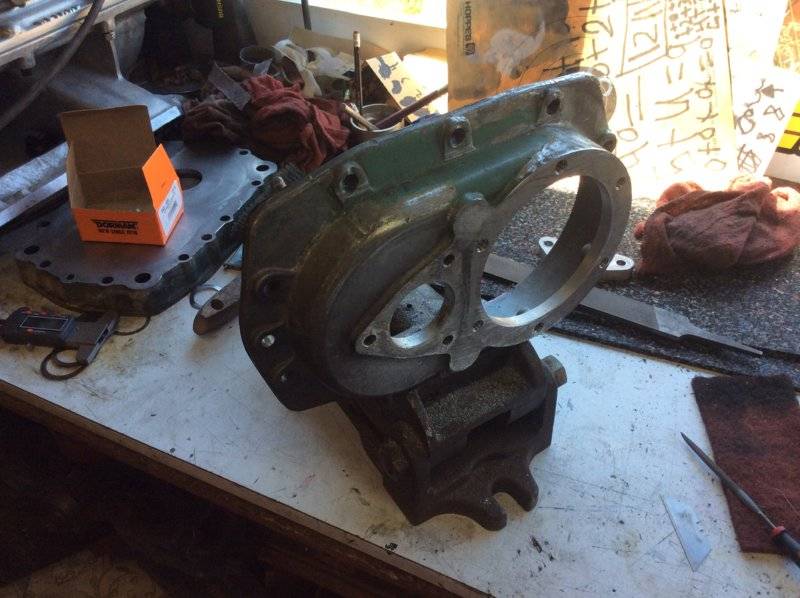

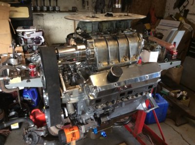

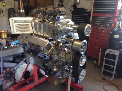

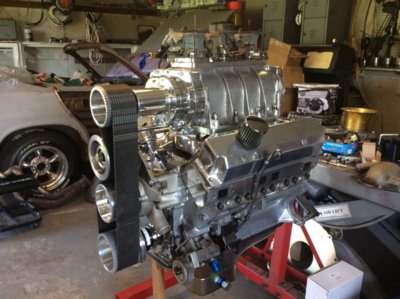

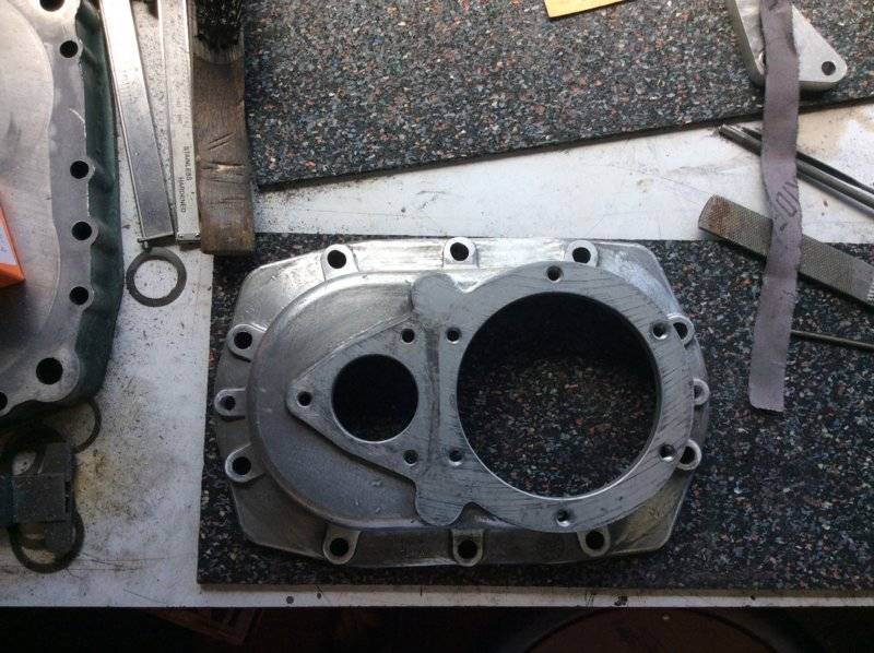

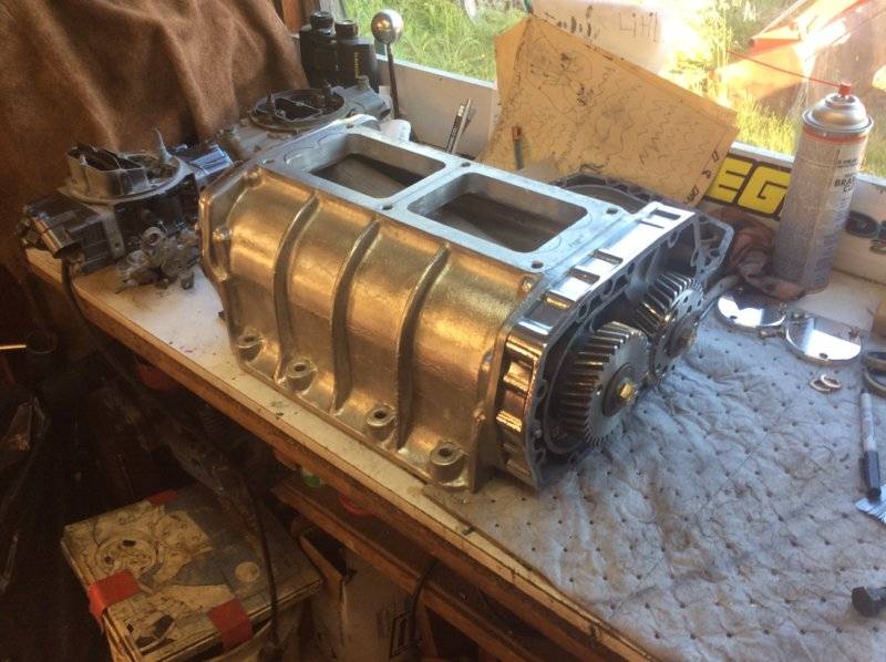

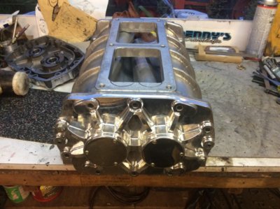

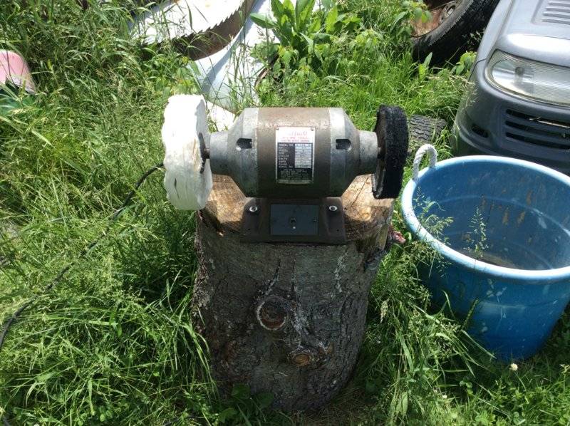

The blower came off a 671 Detroit diesel, it still had the green paint on it, i converted it to gas use and polished the stock front plate and cover, i also fabricated the idler pulley bracket and polished it.

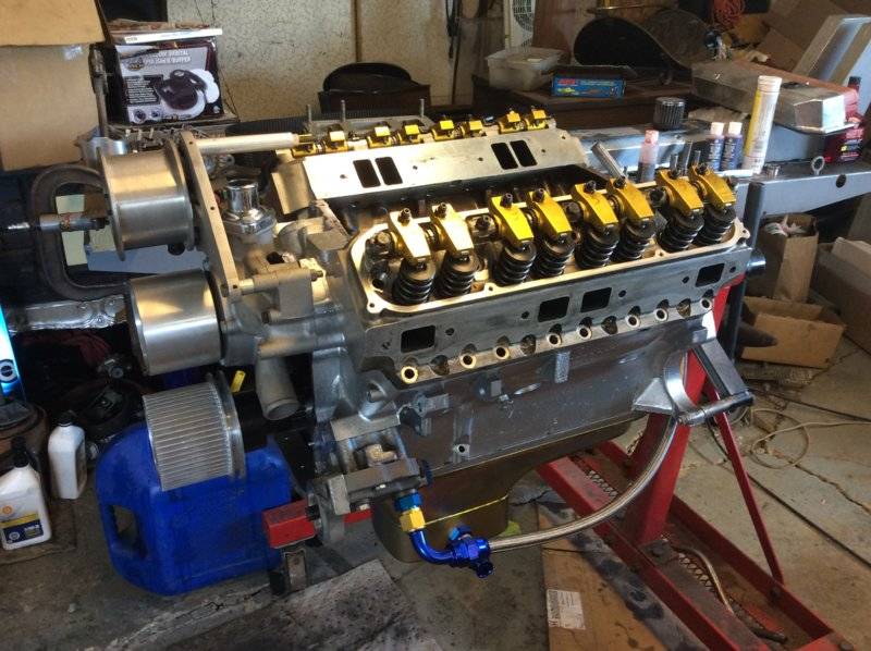

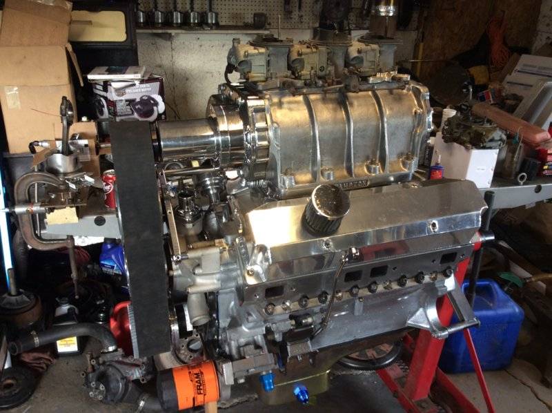

372764B1-9856-4073-948C-6FD38FD665AA.jpeg E270A0B7-43D9-49EF-ACD2-6BDC05F96325.jpeg CDC256FF-352E-420E-935B-B160A45CAE45.jpeg 41141615-E9EC-4714-ADA4-12B3B58128CF.jpeg E5314136-247B-4ECE-858A-F6F0D2876AE1.jpeg
It’s been keeping me out of trouble but that’s about to change, hehehe.
Forged gears? Or Cast? Cast gears gotta get tossed....
Set it up loose if your gonna drive it much... Or have the rotors stripped with UHMW...
It’s got steel gears, I used a manual for moonyham street blowers and clearances it according to the manual, it spins nice and quiet,
Cool! They aren't hard to work on, just gonna pay attention to a few details... I've actually set them up for Diesels & Industrial applications allot more than cars.. I have a buddy that runs a blown alcohol roadster in nostalgia drags that I've been through the blower on a few times... He wants max boost so it's clearanced on the tight side but it only runs 1/4 mile at a time.... If you ran one like that on a street car once it got up to temperature theres a good chance the rotors would hit & lock...

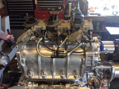

Just about ready to bring it to the shop and have it put on the engine Dyno
