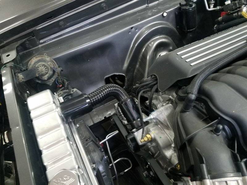

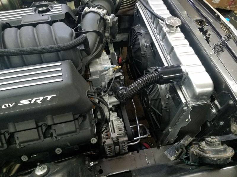

The pic above is the K&N kit tubing. That tine os atleast 2 inches to long. It is also a stock pump. I ended up buying the stock elbow right off the throttle body. Is has the fitting. Plan is to build off that hopefully.

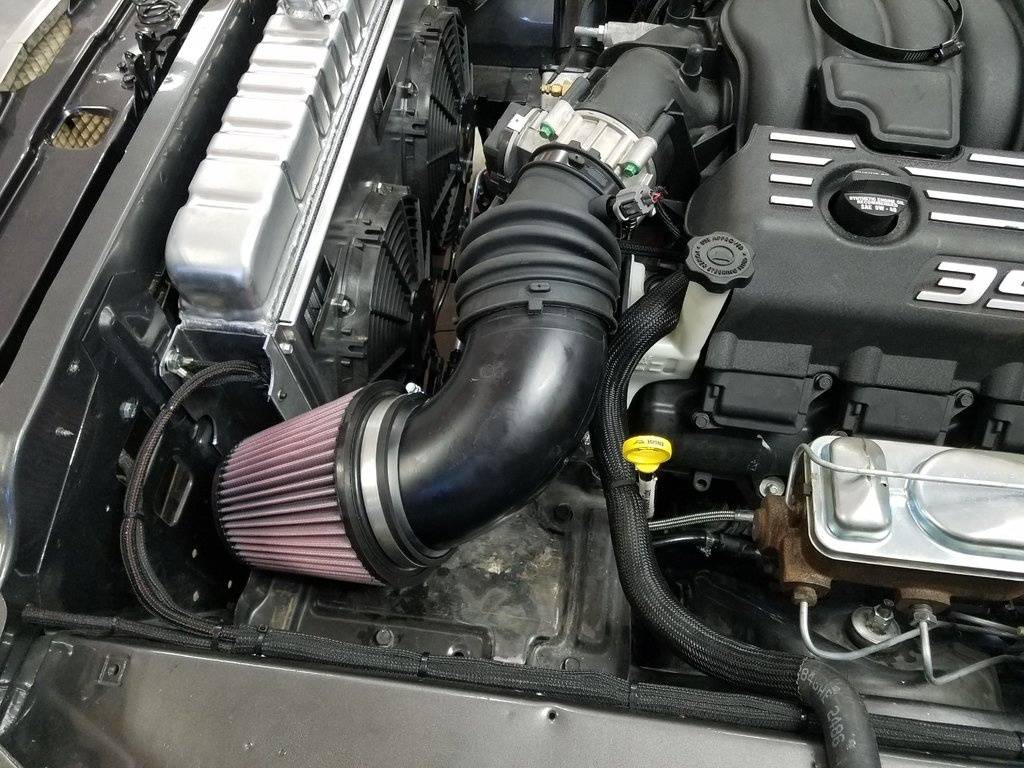

It isn't flashy but it works. I used a stock throttle body boot. It came with the sensor. Then I found a 4" street elbow sewer pipe which fit the boot. The air cleaner slipped right on (K&N RU-5147). Just need to make a mount to hold it. Battery tray is there for short time support. Also need to mount the oil breather.
That looks pretty good!

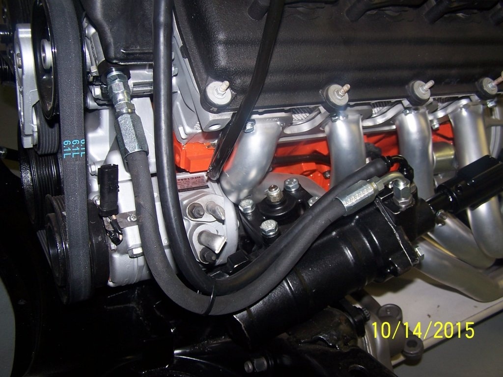

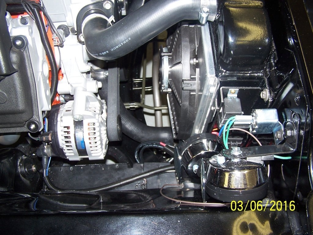

I bought fittings and hose from Bouchillon for my PS lines. I used the Borgeson gear. Here is a pic. Also, I didn't have any transmission cooling lines so I bought some 3/8" tube from an auto parts store and bent my own. I guess I don't have a good pic of the cooling lines except where they hook up to the radiator.
View attachment 409133 View attachment 409134
