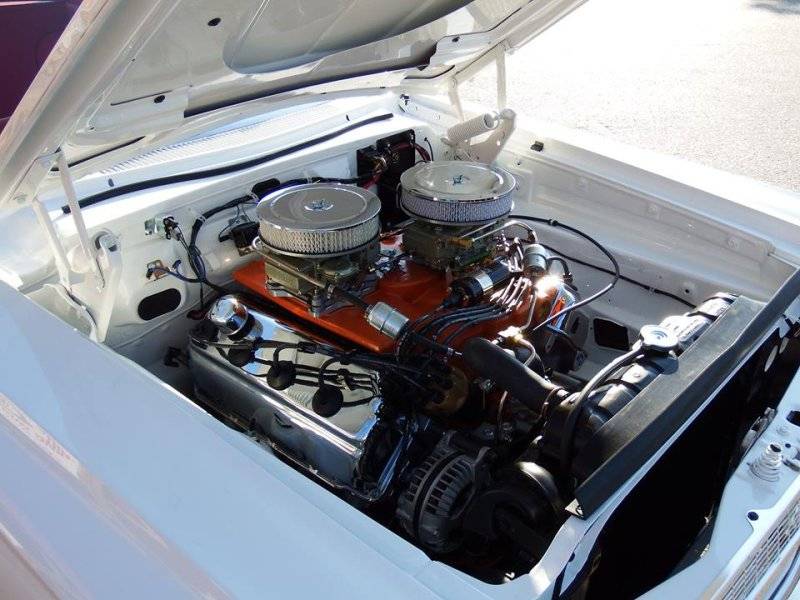

Im 70 yrs young and confess I dont have any experience w/this set-up. Previous owner installed the x-ram I'm thinking for looks. I don't like the way it runs. Puddling and having to run it strong to avoid fouling plugs. Is this common with this intake system? I am open to going to inline 2 carb set-up. I will very greatfully recieve your experienced advice.
Thanks so much.

i had same setup 2 770's on the street.once i tuned my carbs i never fouled a plug. i leaned them out with IFR restrictors, changed pump cams , and 02 sensor. no lean surges with a stick either...
I have a magnesium Hemi cross ram. Never had any issues previously once tuned. I now run a tunnel ram with two 1050's on my current Hemi.
Linden, I run my cross ram on the street. After some tuning, my plugs are looking good. However I find throttle response touchy. It’s either off or on so leaving a traffic light can be challenging without being a squirrel.
Same guy that worked on your car helped me with mine.

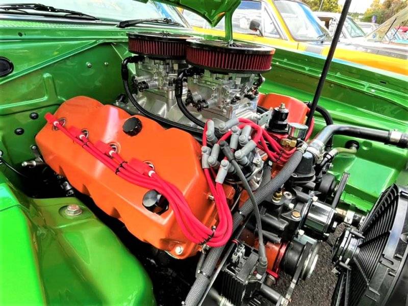

Stage V 2x4 single plane intake with dual Thunder 800s...if you want dual quads.
Works awesome.

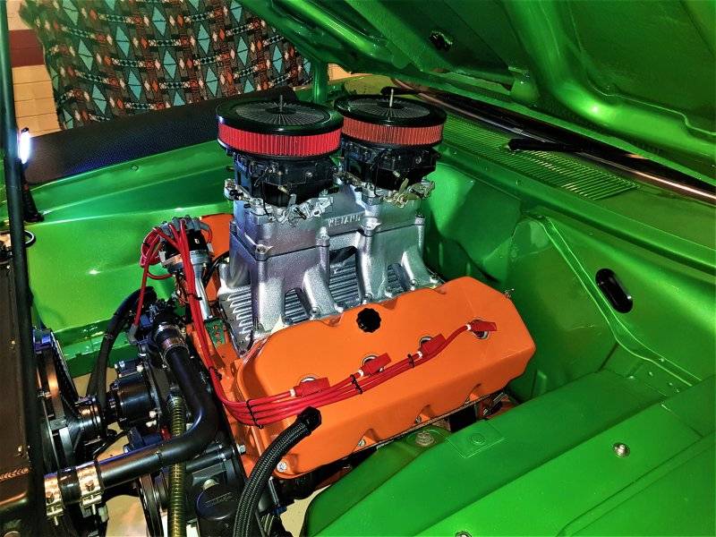

Not sure if you want all the horsepower possible? If so a tunnel ram would do that I am sure. On the street and for the nostalgic look I would keep the cross ram. But I just like crossrams, as mentioned tuning takes a little effort but once done they idle nice and have good low-end torque.

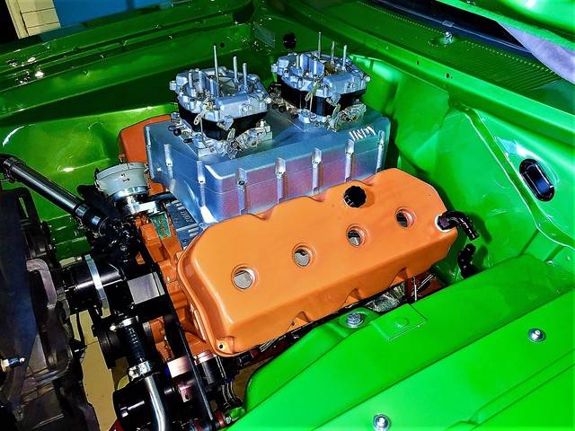

Here's a better pic for ya.....with the Indy X ram and the Weiand Tunnel Ram.
I love dual quads haha.
