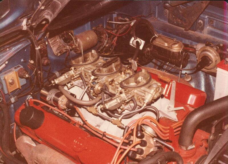

Old shot of my ‘70 Road Runner, I pieced this set-up together from new replacement parts ordered through a dealer I worked for back in ‘76sh. All new ’71 carbs, including the Edelbrock intake. All including the hardware had good part numbers then except the fuel lines, considered non-serviceable parts at the time. Had build them from scratch. Note the cruise control and the wrong color orange engine paint. No one offered the correct Chrysler orange engine paint in spray cans back then, not even through Chrysler parts.
Very cool that you had cruise control AND the six pack setup on your 70 RR. I wonder how common [or rare] that was in 1970?
