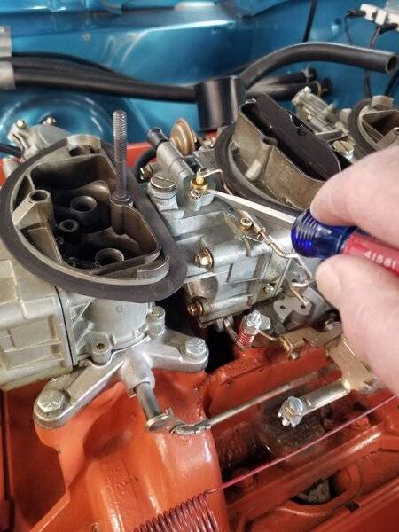

I am having trouble with the center carb on my 70 Superbird 6 barrel. These is a small valve on the top of it that has a piece of linkage that pushes it down. 'Sometimes' it leaks gas, it just bubbles out of it. I just discovered this and am lucky I haven't had a fire yet. This valve (sorry I don't know the name of it) has an outlet about 2 inches over, that on my car has a black plasitc cap on it. The cap was there when I bought the car, but I suspect the leak is caused by the lack of a place for the fuel to go. Question, should there be a hose on this outlet and if so where does it run to? I am pointing a screwdriver at the valve and you can see the capped outlet,3/8" hose,
a couple of inches past the valve.
That's called the Homogutator valve. I don't know much about it, but I do know that you have to be extremely careful with that!
That's a bowl vent valve. And the bowl vent tube on the side should NOT be plugged, it should be connected to the evaporative emissions system. Consult your service manual for the proper diagram.
That is a 1971 style carb. The bowl vent hose would go to a nipple on the breather on the valve cover.
If fuel is coming out of the bowl vent the float level is too high, You have a bad needle and seat or a bad float. It is supposed to vent air and vapor and not fuel.

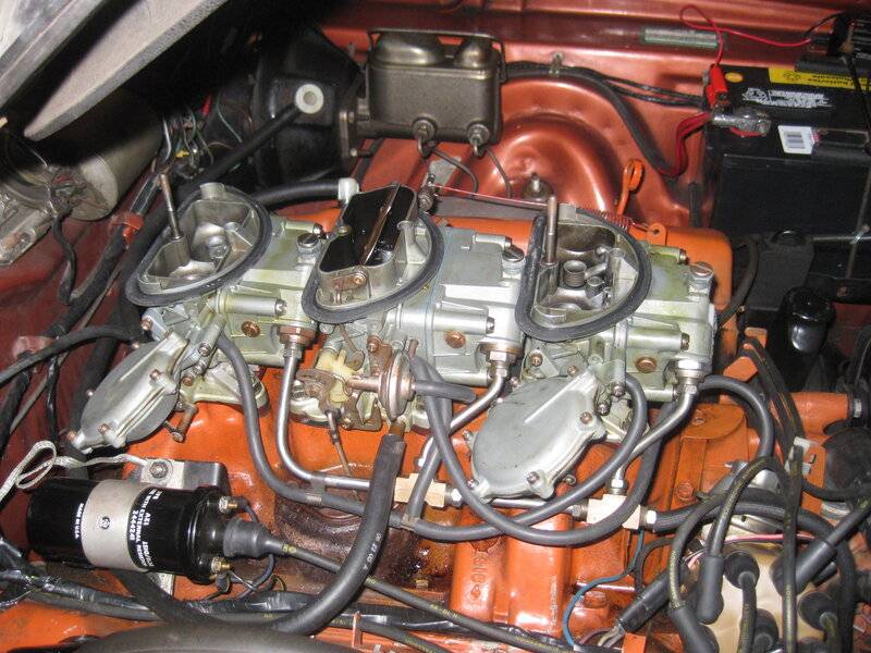

And if you're shooting for originality, on a 1970 6 pak the center carb has a slightly different design as Jim C. has already mentioned above. Pic is from my November of 69 built 1970 Cuda.
The enclosed idle bowl vent valves are correct for 1970, but only on California spec production. If not running an evaporative recovery system, capping it off defeats its primary function. As mentioned, if fuel is leaking at the valve, there is a needle & seat or a float-float level issue.
What is the number for the correct 1970 carburetor? Would Classic or ?? have the correct one. At the least I will rebuild this one and know how to vent it with a different breather on the valve cover. Thanks for all the help, especially the valve name, homo something.
’70 Federal production center carb is R-4375A manual trans, R-4376A auto trans. California or E.C.S cars used R-4374A manual trans, R-4144A. From the looks of the bowl screws, it would appear you may have a later Holley reissue of the ’71 center carb (R-4670A). At some point early on, replacement center carbs, even from the dealer, all came with the later enclosed idle bowl vent bowl and nipple by my experience. If not running a vapor recovery system, should be left open to the atmosphere. Again, shouldn’t be fuel leaking out of the vent valve with normal fuel level in the bowl.

I'm going to take your advice and change out the needle and seat, check the float and etc. And, figure out how to vent it, probably to the valve cover breather although I don't like the look of that too much since it is not stock. That will probably solve my problems, thanks.
