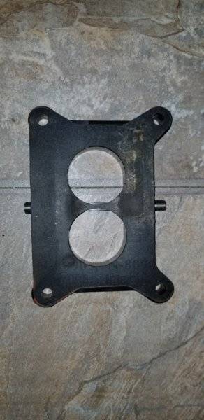

I'm going to order it. They swear the plates fit our Mopar Holley 2 bbls. That will be the first thing I check.

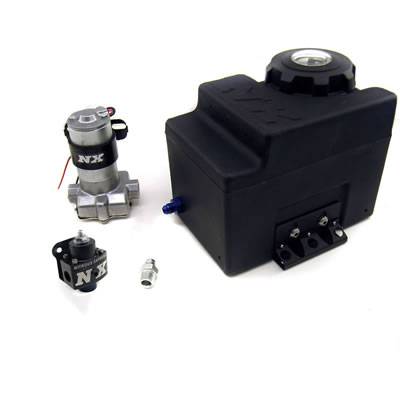

Although "pricey" I am actually considering this as an insurance policy for avoiding timing and lean fuel condition issues, and simplification of the plumbing. I won't go this route until I try the NX system first with a 50hp shot center plate, but if that works, my next step may be to incorporate this. With a gallon of high octane race fuel, it further reduces the need for timing retard.
Pretty smart, but straightforward concept.

There's a guy in my neighborhood running a 351W with a big nitrous system (250hp?) running one of those. It's an interesting idea. I think it would be a really good idea if you could "purge" the fuel somehow when you switched over to it or the first 1-2 seconds of nitrous will be running on your regular fuel. Honestly, all you need is 93 octane unless you have massively high compression. With my 125hp 4bbl. setup, that's all I ever ran and I didn't even pull out any timing....just forged pistons and the old Direct Connection purple shaft 292/509 cam with one Holley blue fuel pump...never an issue.
Not with this stand alone system. ALL of the fuel for the nitrous system comes from the dedicated fuel cell, and the pressure for it comes from the dedicated fuel pump and pressure regulator.
I've wondered about that. I mean, the carburetors are using fuel too, from the gas tank, and that's burning inside the engine with the nitrous too. I'm sure it doesn't hurt to throw in some race fuel with the stand alone system.

After a mix up by NX when they sent a 2bbl spacer plate but I paid for the spray plate, I have the spray plate now. Funds are tight at the moment and I'm sending my carbs to Promax (parts already paid for) so I will test fit the spray plate any day now.
I really like the design how the plate has holes machined in it for NO2 and fuel to come out instead of a bar.
