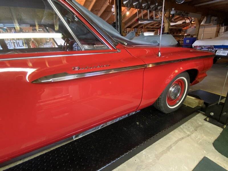

I bought a couple of decent used sets of vent wing window brackets. Looking to swap them out without removing the whole vent window assembly. I got the the two obvious Phillips head screws out and pushed the pin through to remove the latch. Thought it would come all apart but still won’t. The carriage bolt holding the the two brackets sandwiching the window together does not come apart. What else is left? I see a flat head screw crevice is there on latch shaft...to turn carriage bolt?...but the whole thing turns. Carriage bolt must be rounded off or...the square in outer bracket hole is rounded off. I have a feeling I’m screwed. I don’t have an extra carriage bolt/latch shaft. Any thoughts/advice appreciated. thanks , Bob 79F6E38F-1FEF-427D-9C1E-99A4DE99B3EB.jpeg
