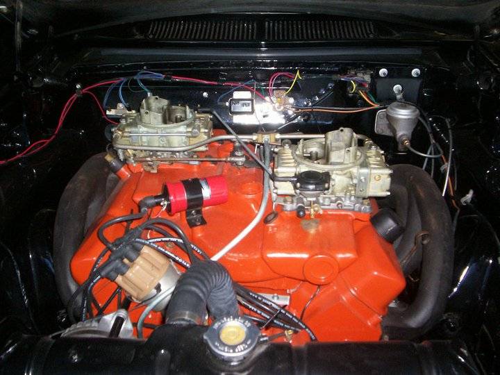

here is a pic when i had the max in it my car
