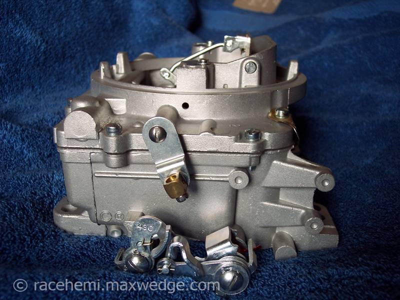

My 3705s have had all of the choke stuff removed, so I can't answer the question for them or 3447s, but if it has a choke (and 3447s did) then I think it must have a fast idle cam.
I was thinking the same thing but I guess not.
They did have the unique valve in the choke plate to prevent choking out.
