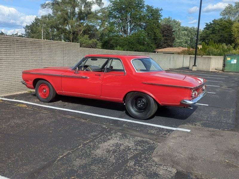

Hey Icetech, great looking car! I see that photo of yours with the grey brick and i said that looks like Michigan! Seen you are from Macomb! Lived there in that area for 30 years and now 34 in Mississippi. Lived in Hamtramck, Warren, Roseville, Utica, Rochester Hills. Go back every year for 4-5 days with my high school buddies. Great state, great car culture, still my "home". LOL.they add some picture compression or something? that pic is super clear here on my pc.. when i upload it, it looks like it was taken in the 90s
I grew up in warren (8 and vandyke) work in utica.. live in macomb now..Hey Icetech, great looking car! I see that photo of yours with the grey brick and i said that looks like Michigan! Seen you are from Macomb! Lived there in that area for 30 years and now 34 in Mississippi. Lived in Hamtramck, Warren, Roseville, Utica, Rochester Hills. Go back every year for 4-5 days with my high school buddies. Great state, great car culture, still my "home". LOL.
11 and Mound, before 696. South elementary school.I grew up in warren (8 and vandyke) work in utica.. live in macomb now..
11 and mound... where the cop sits under the overpass and you can't see him til it's too late... i went to centerline11 and Mound, before 696. South elementary school.

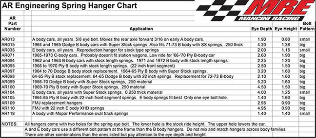

How much did you move the rearend back, and how?
I believe it was 1.75" i used longer hangers from mancini.. not sure which ones now but you can measure the current ones and use this chart to get a longer one.. The rear hangers didn't need anything done they still have plenty of room..How much did you move the rearend back, and how?
I have never seen that chart before, that is useful, thanks.I believe it was 1.75" i used longer hangers from mancini.. not sure which ones now but you can measure the current ones and use this chart to get a longer one.. The rear hangers didn't need anything done they still have plenty of room..

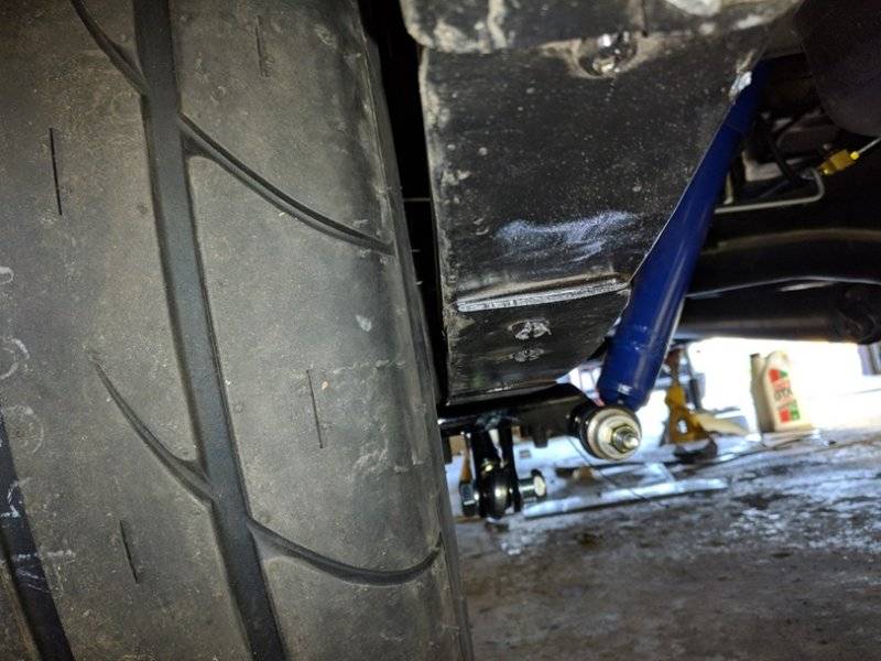

I also moved the front of the springs in around 3/8" which gave me room for the 30x10.5's.. basically just moved the new hangers up against the frame and used 2 bolts and welded the hanger to the frame also. (made a hole in the frame for the spring eye nut to sit in and welded it to the hanger.. i wish i had done both holes though) And moved the perches on the axles.
honestly, no idea..i moved mine so it was up against the floor to try to sit a little lower.. of course now i'm very close to rubbing and didn't weld the nut on the lower hole.. if it's even an issue i can reverse it though no biggyI gave never seen that chart before, that is useful, thanks.
I am assuming "eye Depth" is from the mounting surface, but where exactly is eye height measured from, not wantimg to assume?

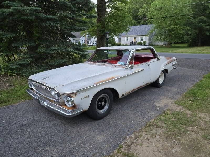

Thanks. I was just curious. My 62 Savoy rear is moved back an inch too. Redrilled ss hangers. Room for 30s, but not as much room as yours! I've got 10.5x28s on mine.I believe it was 1.75" i used longer hangers from mancini.. not sure which ones now but you can measure the current ones and use this chart to get a longer one.. The rear hangers didn't need anything done they still have plenty of room..
yeah.. i might move mine to the lower holes, just a lot of work to do it now. the 30s barely fit.. they will rub on the outer well if i go over a big dip.. has only happened like twice, but that area is all smoth curves, nothing that can hurt the tires.. so not too worried bout it.Thanks. I was just curious. My 62 Savoy rear is moved back an inch too. Redrilled ss hangers. Room for 30s, but not as much room as yours! I've got 10.5x28s on mine.
I had excess rear body lift with the stock 62 springs, so I used a lower location on the hangers to cut down on the body rise at launch.
I have 275/60/15s on the back of my 62, a 10.8 by 28" tire, stock suspension, plenty of room.
What size tire on a 62 requires moving the springs?
