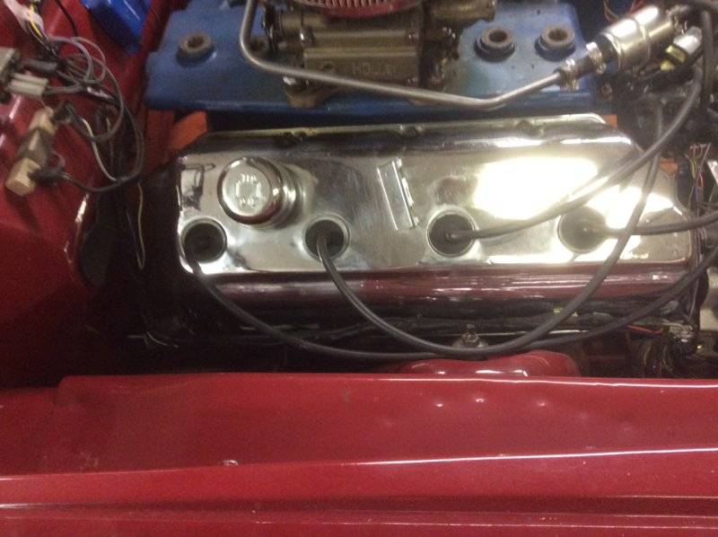

I made engine mounts traced from a 66 k frame. Mocked it up so there was a 1/2" before welding in mounts, set back was 1.5". Don't know if a max wedge will even be further back but think so. MO you only need to modify pass side? You won't be able to access bellhousing bolts from top.
