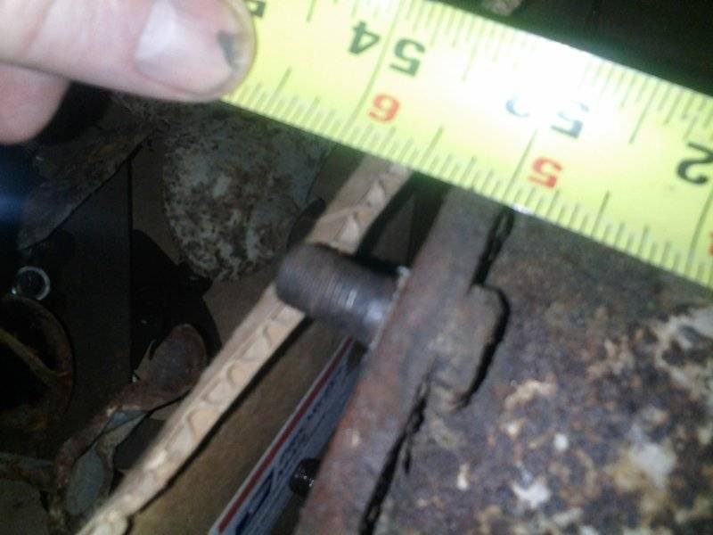

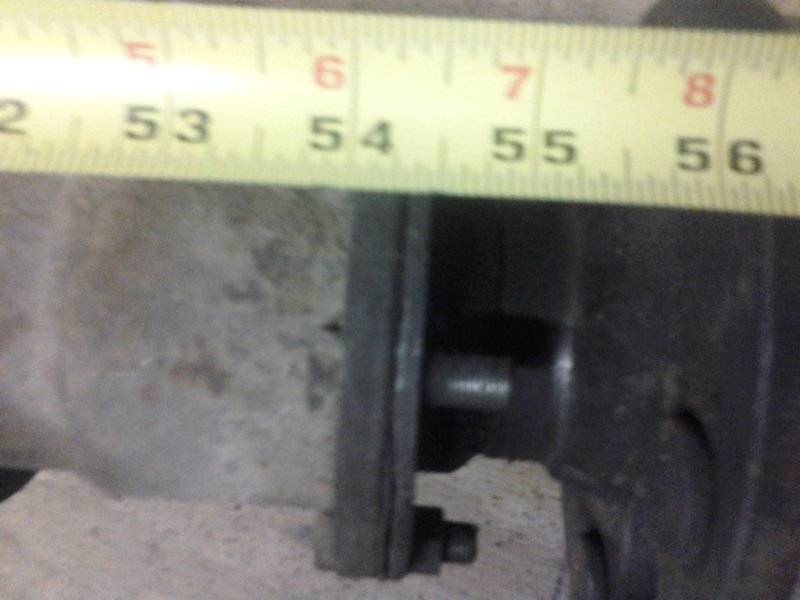

The typical 65 B Body rear measures 54 5 /16" and I had one from a 63 Dodge 330 that measures 53 5/16.
With Cass being able to do virtually anything you need to do with axles I figured I'd keep the 63 rear around just in case I needed something a little shorter in the future...It's only 1/2" on each side but sometimes every little bit helps...

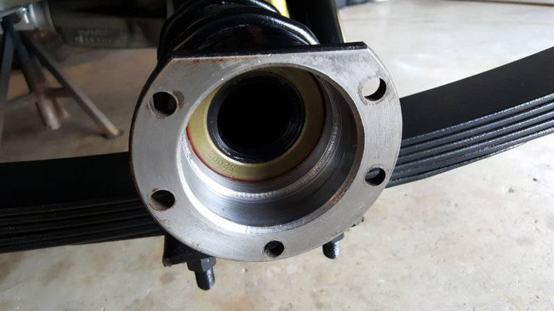

This is my original 1962 taypered axel housing. I used 1970 backing plates when doing the newer flanged axel swap.
