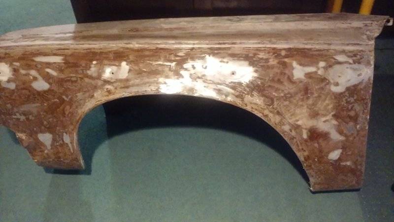

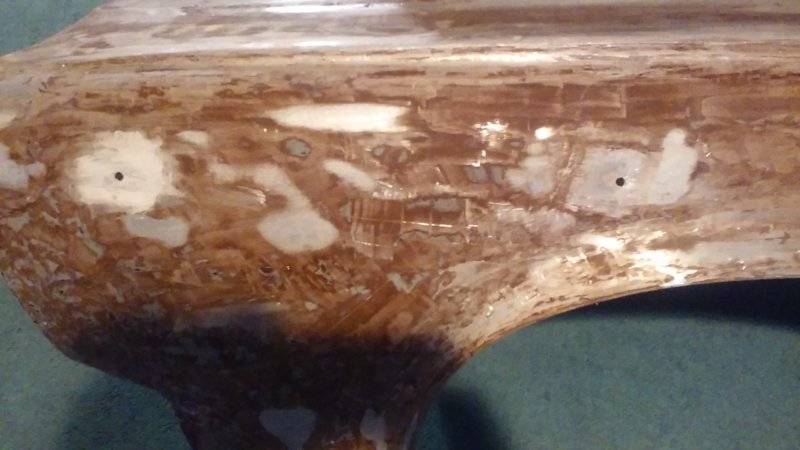

Stripping down multiple layers of paint from my aluminum fenders. So I find 4 holes in the fender that looks like it would be used for molding. Moulding on a 63 Ply aluminum fender! Could this have been a Belvedere fender or Sport Fury fender? Just curious.

Sure looks like Fury type fender. The holes would indicate that. Seems strange because I thought Savoy was the only one with lightweight option. Holes seem too nice to have been drilled in. I suppose one never knows what was possible from Mopar back then.

Your car sure had moulding on it. So then I would guess these fenders came from a Belvedere or maybe Fury. Mine is a Savoy wagon clone car so they didn't have mouldings on a Savoy wagon. Your picture helps determine that. Thanks for the picture.
