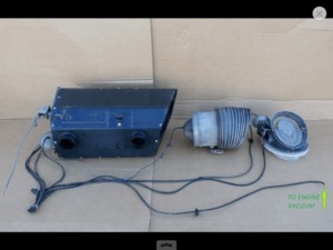

I just got my 63 running again, back to a street car. It hasn't had a heater in for the last 20 years. I have the heater in and wired up but it isn't Putting out any heat. I have miss placed the vacuum connector and lines. Is there a way to just get the heat going with out that until I find the lines? Even if its just defroster that would be ok.. Also is there a place to buy the boot that connects the motor to the side vent? Hopefully mine isn't in the same place as the vacuum lines, because I haven't been able to find that dang booty!

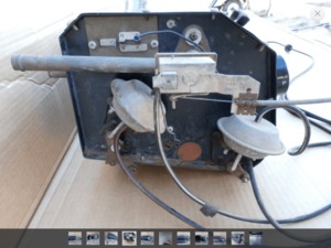

Yes you can push or pull the temp cable (water temp) into a position(see pic below) also the cool/heat actuator (left in pic)
You won't need the large fan pipe (unless you want fresh air ) as it will recirculate the heat.
There are 3 vacuum actuators .
Notice there are 7 hoses , 1 for the manifold vacuum supply & 2 for each actuator (push ,pull) for fresh air-recirculate air ,cool-heat & defrost-cabin.
And a water temperature cable
The concertina type hose for the fan to vent you could trey Joey Suchy ,I have also seen a few on eBay over the years .
Try this for vacuum pipe routing http://www.1962to1965mopar.ornocar.org/ml-62-65heaters.html
