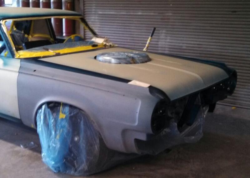

back at the shop, test fit fenders, deck, hood then block/prep. Talked to Joey Cole on tuesday. another month 'till the scoop is ready. gonna shoot the car and do the hood later...

Why wait? Last time I noticed, Domingo has '64 steel and aluminum Hemi scoops ready to ship.
I had one of Domingo's scoops, was not impressed with the quality, definitely not in the same league with Joey Cole's scoops although I did not have the long wait time to get it as you do with Joey. Another issue was the incorrect location of the mounting holes on Domingo's scoop even though he claims them to be exact copies of originals. I got an original and ended up with a bunch of extra holes in my hood that needed to be filled.
Thanks Hemlock. waiting doesn't bother me right now, there is a ton of other work to be done. I'll start getting a little anxious in a month or so...

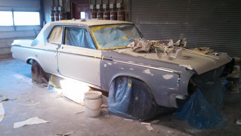

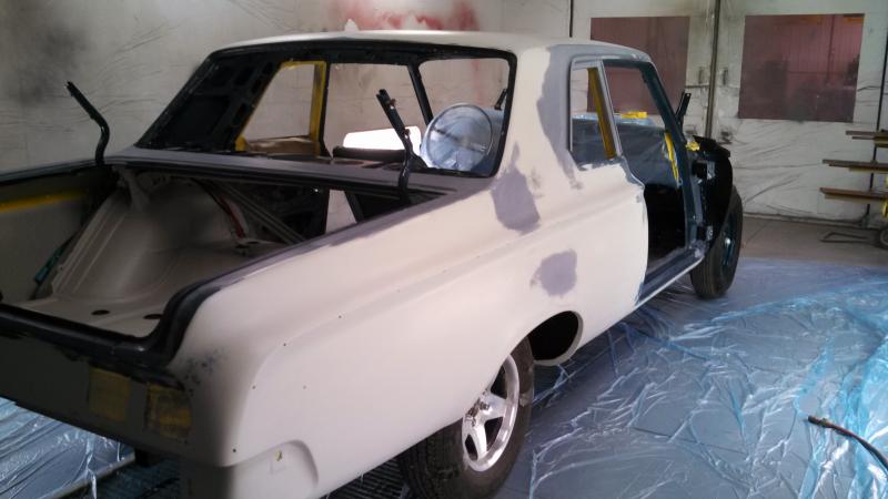

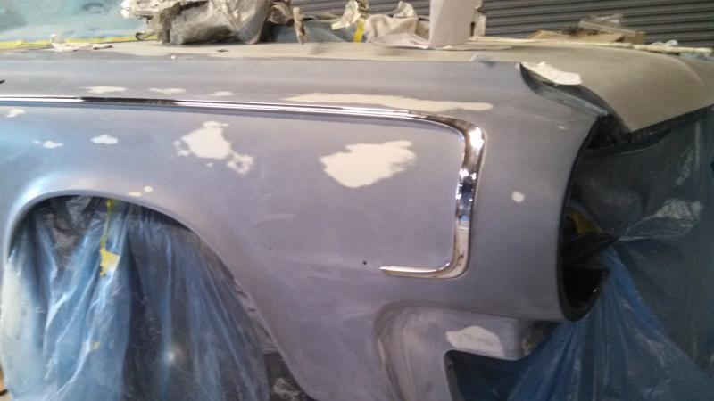

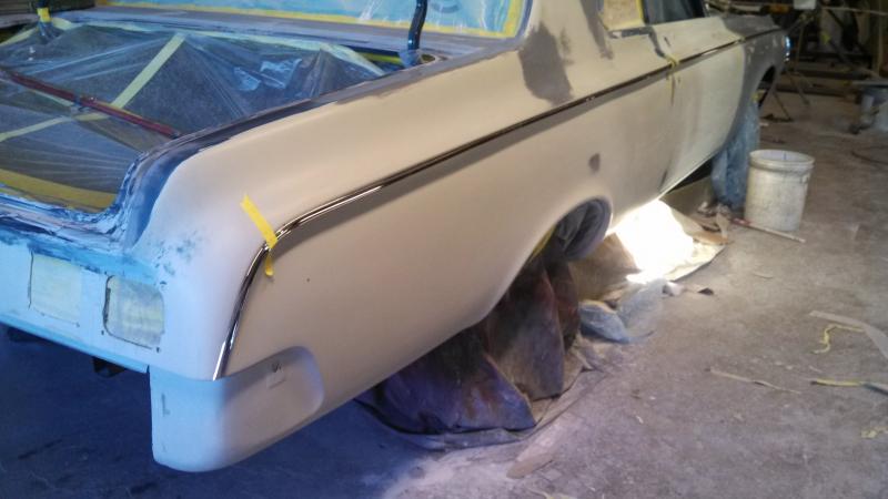

finished the 400 wet sand and test fit some of the SS. should color shoot end of next week. I Wish everyone a happy and safe Memorial Day Weekend!!!

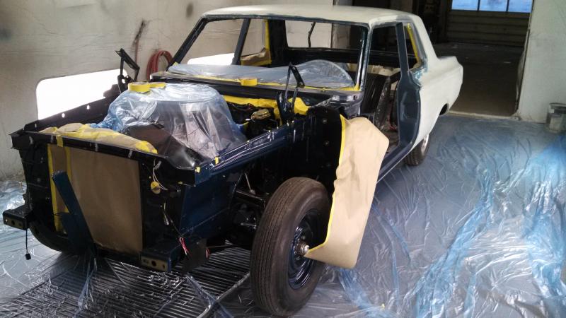

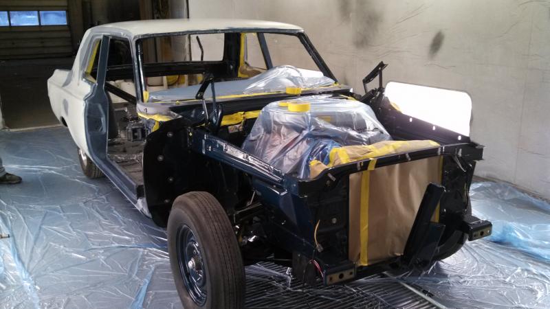

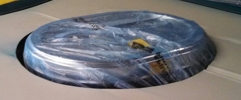

in the booth ready for the "bagging". will finish out the last of the masking and prep work today and shoot/bake on Monday with the doors fenders and misc parts.

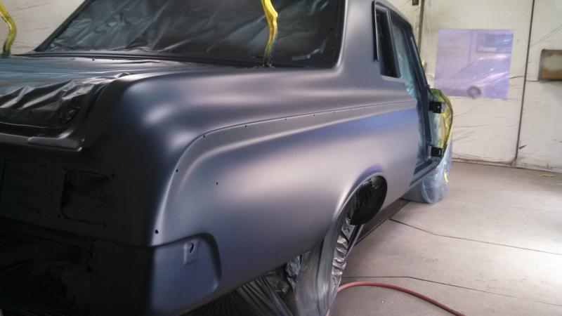

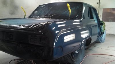

only base and then base w/clear. with any luck we should be hanging doors, fenders, deck and some body molding by the end of next week.
