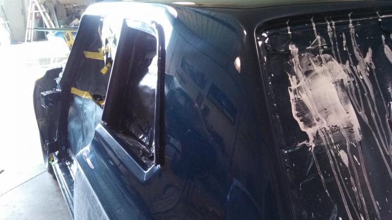

Thanks Polara!! If i can get DW to ride with me and get some footage I definitely will post. A quick update; the guys are color sanding right now with 1200 then 1500 then 2000 and finally 5000 before buffing on thursday or friday...

first cut w/wool after 5000...

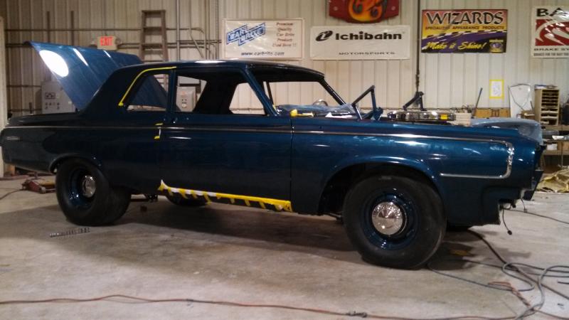

just so ya know we haven't been sleepin' this past week.

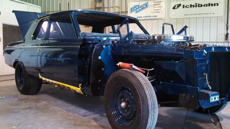

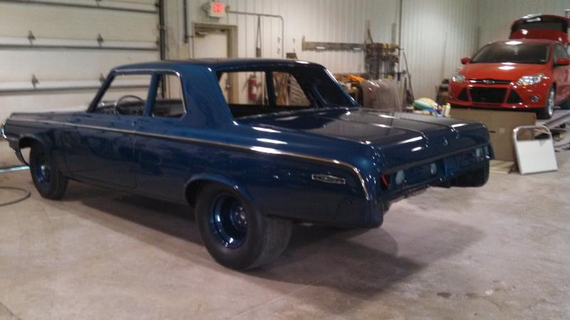

cleaned up and heading for alignment and exaust. you can see the color diff. when in photoed in natural light.

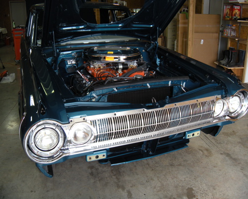

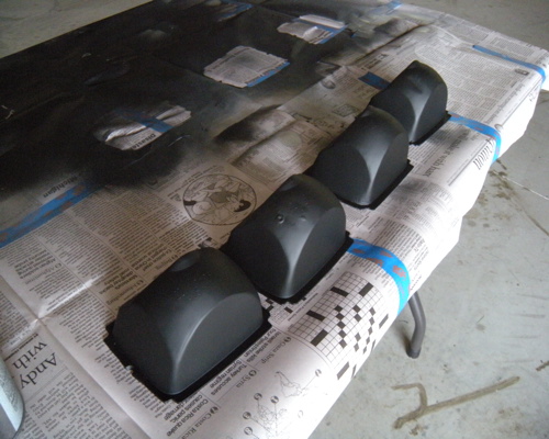

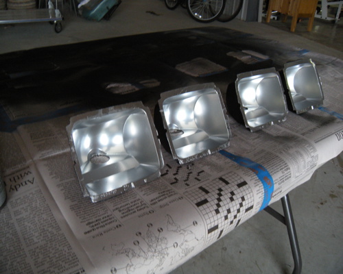

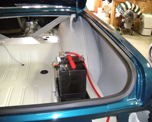

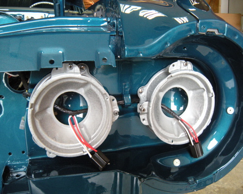

today installed the trunk seal and worked on setting the grill and the tail lights. shot the housing of the tail lights. exterior with flat black and interior with "chrome" paint. hate that stuff but in this case, it will work well for reflection inside the tail light housings. didn't "in-paint" the black on the headlight doors or the grill. wanna see what it looks like as an all chrome and polish front end. went for a maiden run; about a mile out and back. DW asked "when will the wind shield go in?"... 60 mph gets a little breezy... drove like a cloud.... a 500hp cloud...:jerk:
