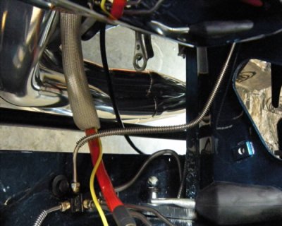

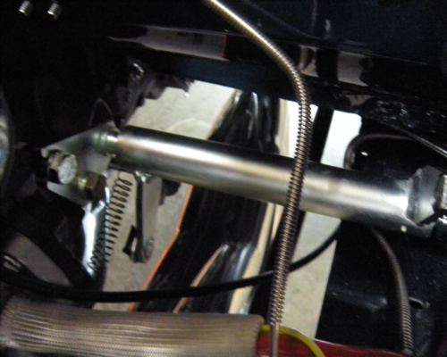

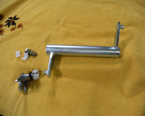

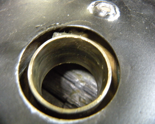

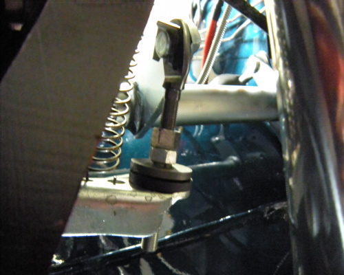

yesterday, picked up the driveshaft and installed, set the torsion bars. tonight installed the clutch bell crank (z-bar) and linkage.

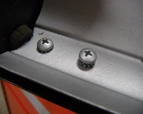

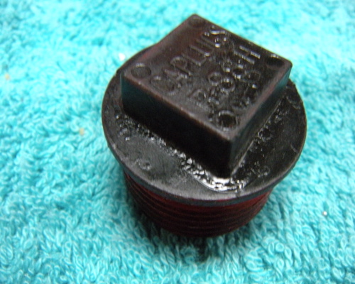

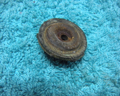

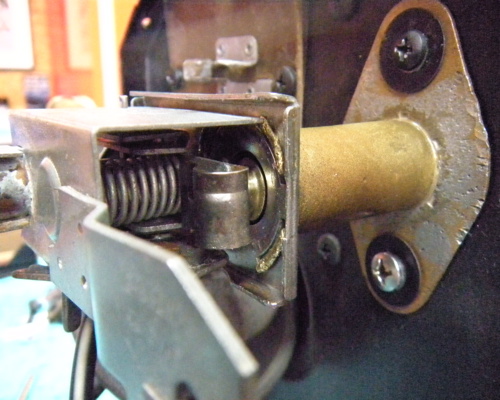

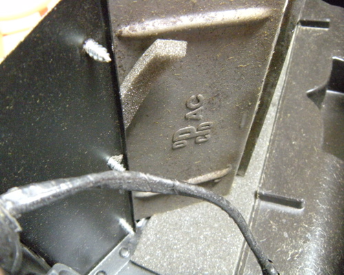

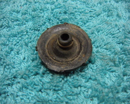

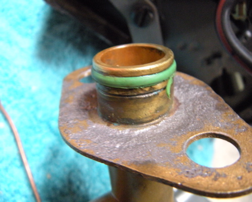

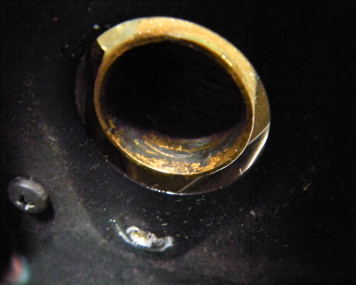

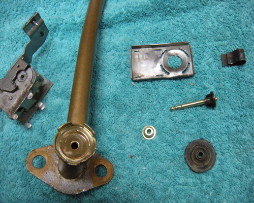

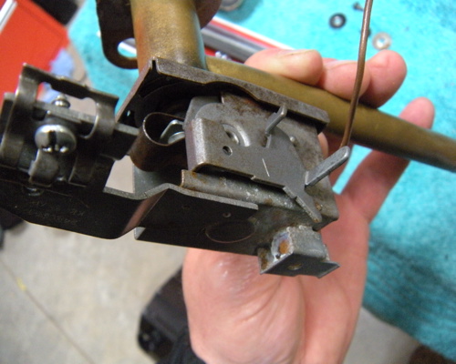

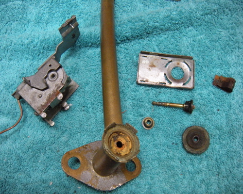

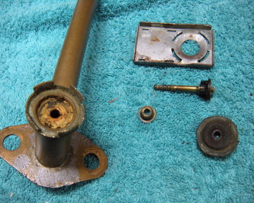

dropped the heater box today. found that the heater valve was leaking not the core. bought a rebuild kit online. took about 45 min to remove, 45 min to disassemble and clean. little honked about the poor assy of the rebuild from the vendor and the fact that it leaked in the first place. anyway here are some shots of; bad seals, loose screws, before and after of the valve was disassembled.
a couple more....

Well that sucks to have to rebuild the rebuilt heater box. Like they say, If you want it done right...

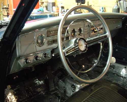

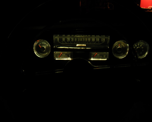

Was only going to run the initial break in for the trans and rear today (put 1.3 miles on the car and never left the shop) but got started and one thing lead to another. set the steering column, and the wheel. checked the brake lights, turn signals, parking lights and horns (nothin' like the old spartan hi/low horn combo). had a little trouble because the sockets needed to be grounded for everything to work correctly. figured that out over lunch, beer and a tuna sandwich. discovered the new brake light switch sticks (plastic POS) so I dug out the orig. switch, tested and installed it, all good.
couple simple shots. one of the gauges in the dark and the wheel. it's a 440 wheel, but i'm goin' with it for now, until i find a good 330 horn ring and center to use. spent the last three hours of the day mowing. first for the season and still very wet in the low areas.

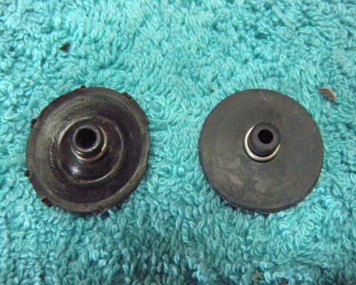

Here's the "rebuild kit" a replacement seal. absolutely worth the twenty bucks. once reassembled, it held pressure and functioned perfectly. this "kit" will work for ANY Ranco H16 heater valve used from the early 50's to the early 70's. also took the car down the drive. first time out and nothin' crazy... though I gotta say it makes ya feel "ten feet tall and bullet proof"...
