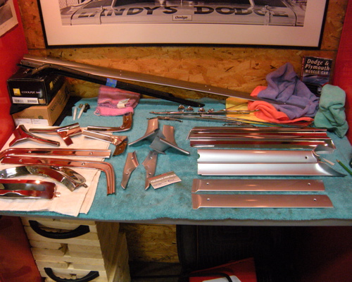

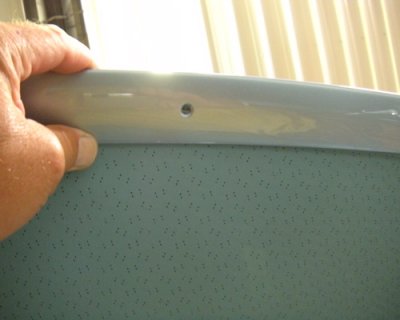

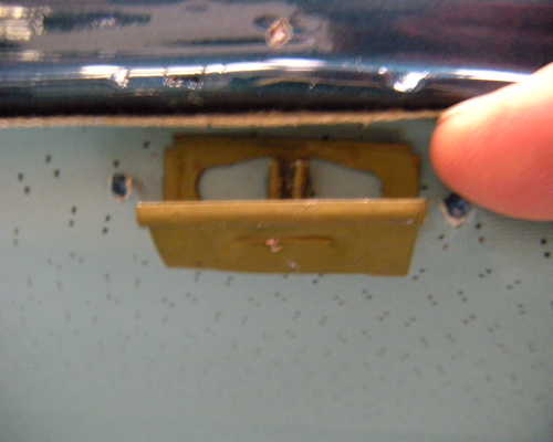

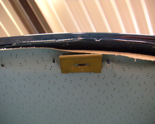

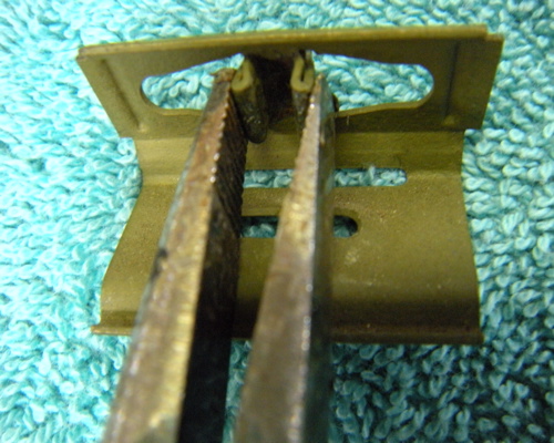

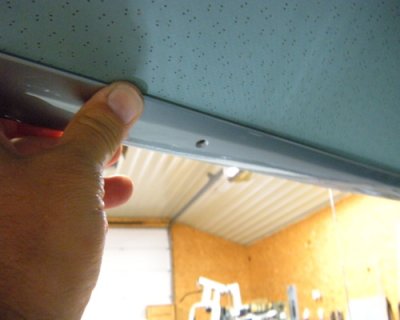

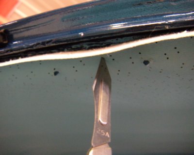

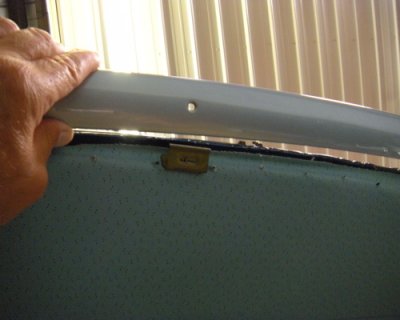

well the weekend didn't work out the way i'd planned but, crap happens... anyway here are some shots of the exterior trim clips and the interior headliner garnish clips (order isn't exactly right). some of these clips are new from restoration specialties (RS) and some are from the orig. car but all can be purchased through RS. It's important to sweat these details for the interior to turn out right as it is said; "if you don't sweat the details, you end up with entrails..."

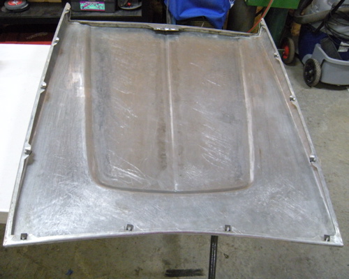

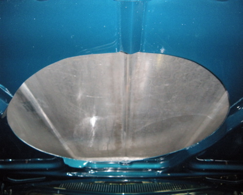

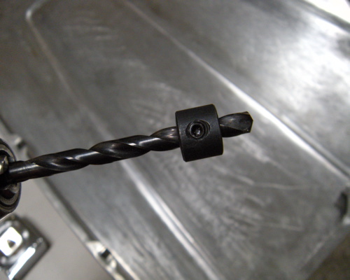

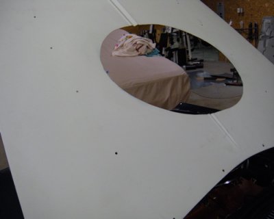

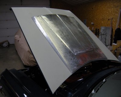

Got tired of waiting for help so I mounted the scoop. Made some "marking" studs out of 10-24 rod and used a bit stop so I didn't plow into wires, hoses, valve covers, etc... Also found a place in Florida that converts/upgrades AM radios to FM w/additional leads for iPad, iPod, Satellite radio service so I installed the radio delete plate until the stock box comes back. 30 to 60 days.

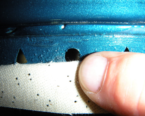

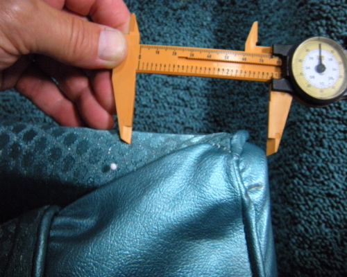

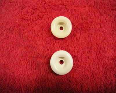

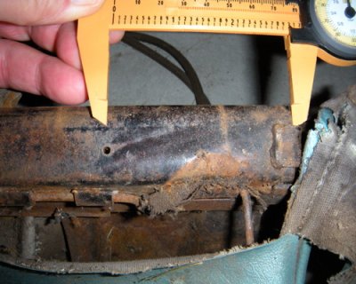

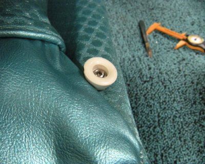

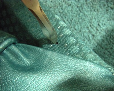

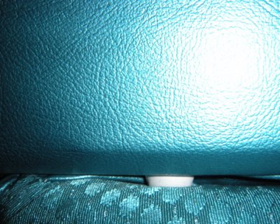

point of detail. the seat back bumper came today. The seats really look "lazy" if these little guys aren't installed. The measurements are off the old donor car seat base and the white dot is a sewing pin used to locate the hole without damaging the fabric. a trick i learned here from HitIt. the last shot show the drivers seat with and the pass seat without, but I don't know how to turn it, soooo.....

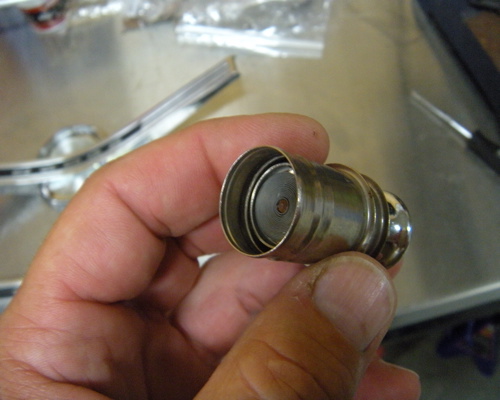

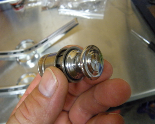

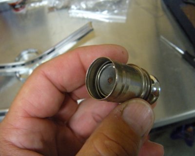

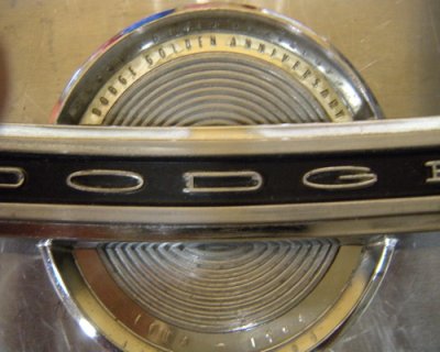

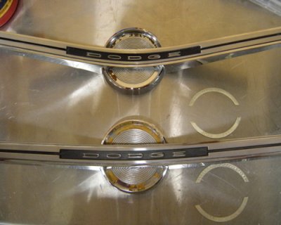

Went to Columbus for the Mopar nats and scored some items. A damn-near perfect cigarette lighter. guy had it inserted in a beat up '64 ashtray assy. (might have been a '65, but still period). when I pulled it out i noticed it had never been used! asked if he'd sell just the lighter; "Yes, 3 bucks." SOLD!!! also picked up some near perfect defroster vents. those things, being plastic, didn't survive well, mine are very brittle. these will be a nice upgrade. also picked up a 330 horn ring and horn bar. I will eventually replace the Polara assy, probably this winter. I'm gonna re-plate both horn bars and use the better one. Someone may want to buy the other.

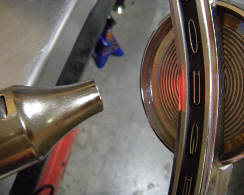

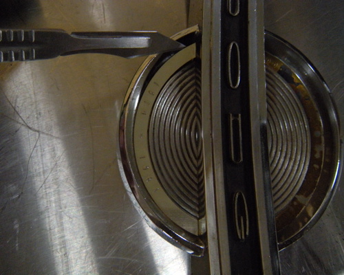

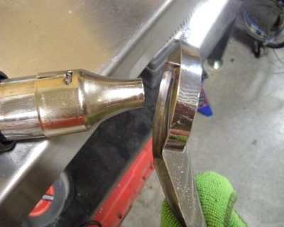

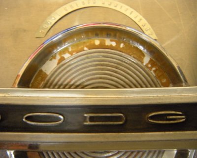

The problem with getting the horn bars re-plated are the small aluminum stamped inserts glued around the center reading "Dodge Golden Anniversary" & "1914 - 1964". These need to be removed in order to not ruin the slight gold hugh that they have during stripping and re-plating. Heat is the answer to the removal issue. A good electric heat gun works nicely to soften the old adhesive and gently lifting them out. Reattaching will be no big deal with todays adhesives. After removal it's just a matter of cleaning the old "horse hoof" glue from the back side of the badges. These things are delicate and I might have DW take care of them so my fat mitts don't' run them. I'm can't imagine replacements are available.

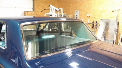

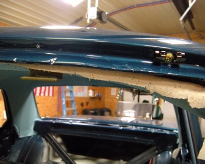

last night was the rear window and trim. also test fit the inner panels. next is front window, package tray, and inner panels. also delivered the hood and scoop to the painter. should be done in a couple weeks.
