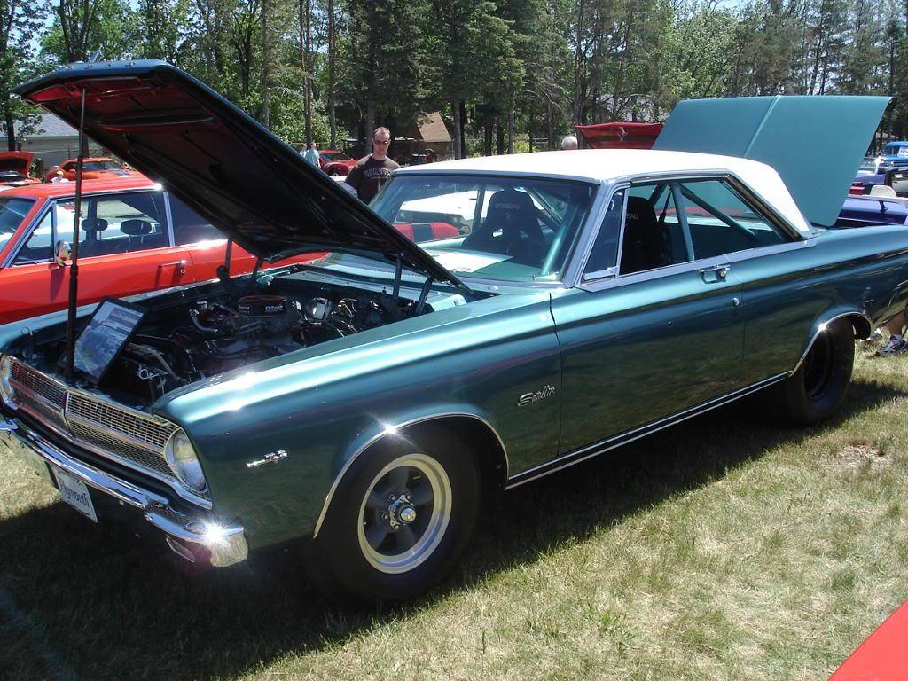

keep up the good work on your restoration. reminds me of mine a few years back. i went with the same dark turquoise on my '65.View attachment 104859
When I see that car at Mopar's in the Park I stand and look for hours....that is a great car!
This was from '09, looks like you swapped out the wheels.

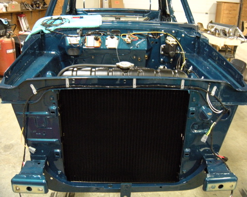

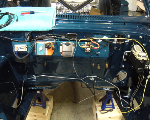

been chippin' away at this for about 2 weeks. doghouse harness in w/relays and regulator. will wrap the leads to the devices with loom wrap once everything is placed. Master cyl. in and dry fit the radiator I picked up at Indy last weekend.

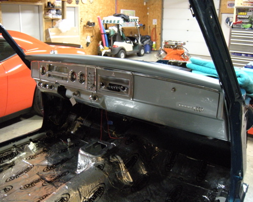

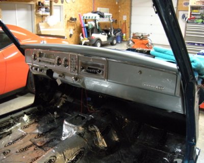

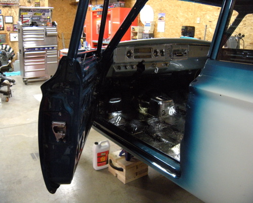

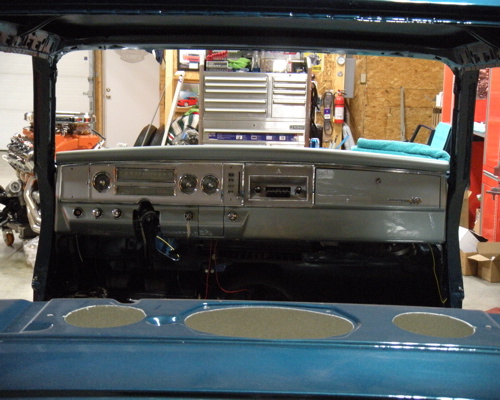

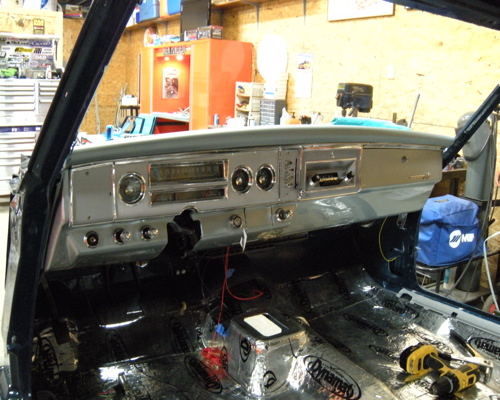

friend stopped by this morning. installed the dash, tied in the dog house harness, the rear body harness and the rocker panel sill wire guards. probably about 3 weekends away from setting the engine/driveline.

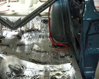

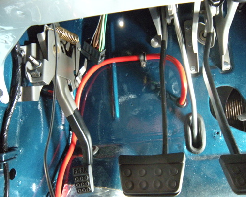

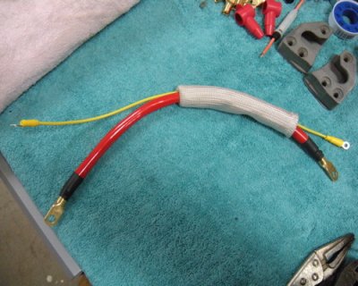

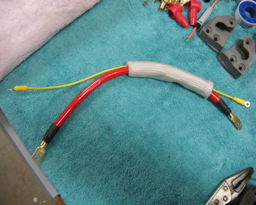

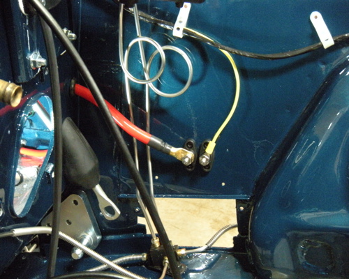

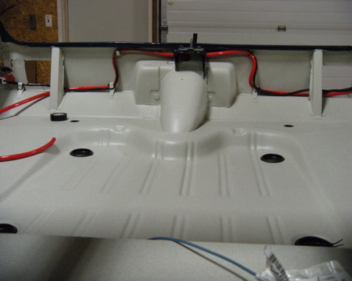

over the past week tied in the dash brackets, ran the tach signal lead, bonded the dash grounds, set the bonding blocks for the starter/batt. line and solenoid, ran the batt. cable to the trunk, made up the "jumper" from the starter to the bonding blocks on the fender well.

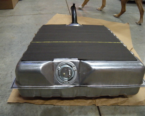

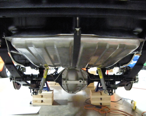

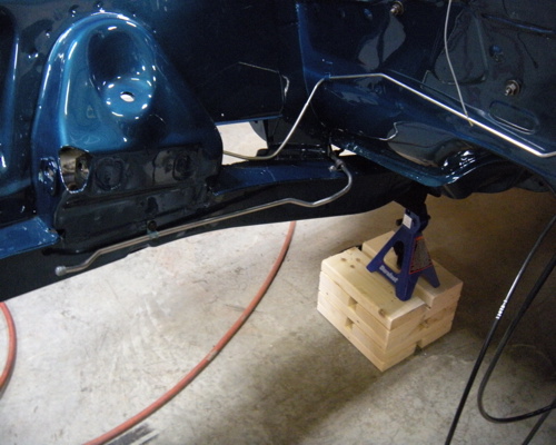

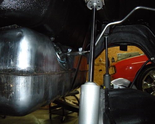

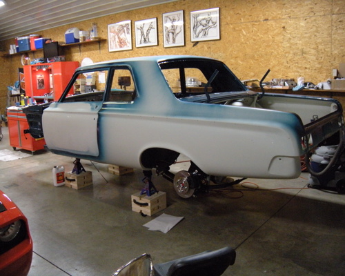

daughter and her boyfriend stopped by, put him to work. we set the tank, ran the fuel line, hung the doors. line didn't fit as well as I'd like but not bad, had to re-bend around the front frame rail and add a couple SS P-clamps to feel good about the install.

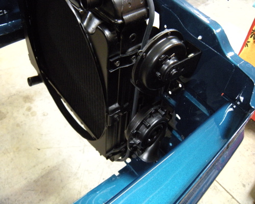

couple of fun shots. one of the tank (thought it was in the last group) and of the horns, restored, and mounted.

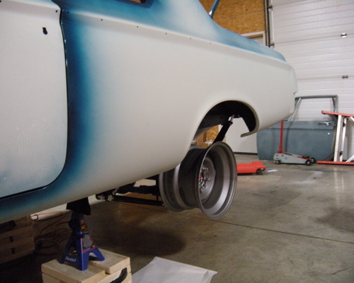

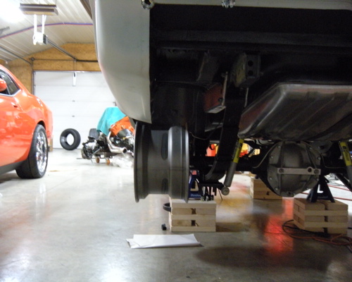

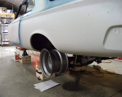

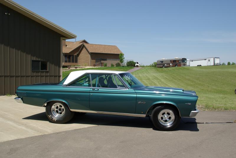

stockton wheel
Boy, I bet that will handle real good on a train track, lol!!! Size?? You should be movin' to the front of the car shortly, hint-hint, lol!!
:-) 15x10's large dog dish center. 4-3/4 BS. will mount 15-39 hoosiers street tires to start an also have the 15-41's but not sure they will fit. Might have to sell those. we'll see.
