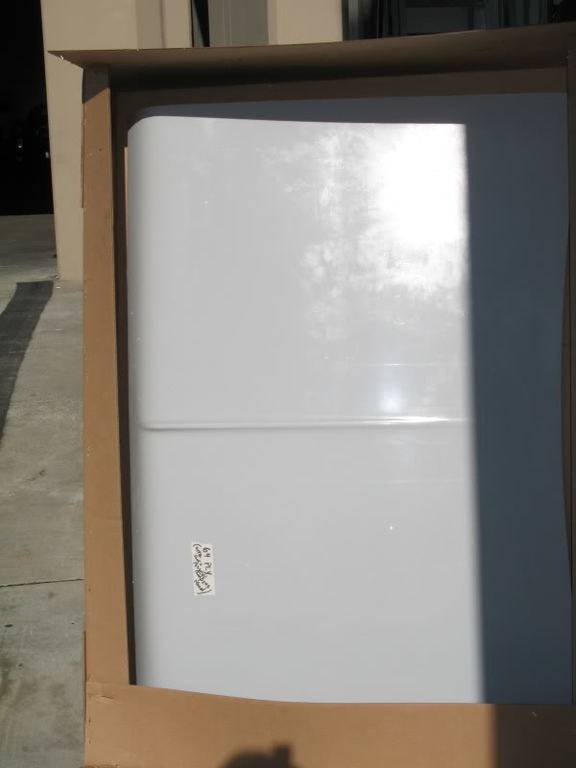

Damn, does life get in the way of fun or what? What with work and holidays I've been delayed for weeks again :banghead: but I'm not giving up yet, especially because my fiberglass body parts arrived today (save for the Hemi hood scoop) from Sled City.
The parts may have taken a LONG time to get here (better than 5 months) but I have to say their product quality and packing is terrific. All the various holes and mounting locations appear in their correct locations (as much as I can tell at this point) so hopefully a great deal of the guess work will be taken out of the reassembly.
One thing I have to make note of here, and it is NOT a surprise to me: the body parts I purchased are EXTREMELY light, especially in view of their physical size, so if you decide to buy parts from Sled City don't think you're buying heavy duty, high-wear pieces: they're not. When I unpacked everything today the sun literally shone right through, and while I don't mind I wanted to make others aware of the fact.
On to the body parts!!!!!
Hood, minus the Hemi Scoop - 19 lbs
Trunk Lid - 11 lbs
Fenders, WITH light buckets completely molded in - 14.5 lbs

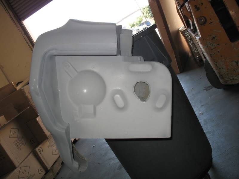

Detail of light bucket
Doors (outer) - 16 lbs
Doors (inner)
Bumpers (front and rear)
I haven't weighed all the stock parts yet, they're stored around the shop, but I will during the next couple of weeks and post the weight savings.

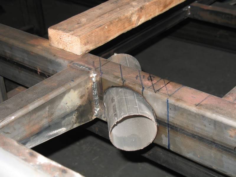

Once we got the rear housing done we moved on to the exhaust routing. If anyone ever tells you truck arm suspensions are difficult to package, TRUST THEM! As noted in an earlier post I decided to run the exhaust out the sides, which I would have done whether I ran truck arms or not, but still, packaging is TIGHT! While I worked on the doors (more on that below) Jimmy set about lining working on the headers, tubing, v-band clamps, and cutting the holes in the frame.
The first step was cutting off the flanges of the TTI headers so the ends would be perpendicular to the frame then tacking on a v-band ring and lining up the first piece of exhaust tubing. From there we figured out where we wanted to cut the holes in the frame, which Jimmy did using my handy little plasma cutter. It was the first time Jimmy (a VERY accomplished fabricator) had ever used my cutter and he was stunned at how well it cut, comparing it to his FAR more expensive shop unit. Below are a couple shots of what we ended up with:
View from above through the drivers door:
View from below at about the same location:
Once we get the headers back from coating (we're using this trick looking Titanium colored coating) we'll go ahead and solidly mount the stainless exhaust tubing in the frame, then mate up the mufflers (as shown in an earlier post) and other stainless tubing.

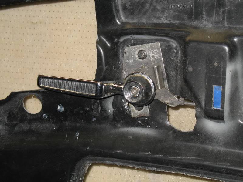

The glass doors are remarkably detailed, and if this was a track only car I could simply bolt on the pieces I need, but since it's a street car I felt the glass was far too weak to simply bolt on the striker, window cranks, door pulls, etc., so I've been dissecting the original doors and sourcing the metal to use in the glass doors. While I wish I could simply use the donor metal as backing material that isn't always possible, so in places like the striker I have to carefully line up the donor metal, remove the fiberglass, then meld the metal into the glass door. It's actually been pretty enjoyable, but just another unforeseen layer in the build.
One thing I found that's really aided in the process is a 2-part structural adhesive from 3M, part number 051135. This stuff has a pretty short pot-life but it seems to be EXTREMELY strong while remaining less than brittle.
Here are some shots of the doors and the work that's had to be done.
Striker area:
Outer Door Handles:
Inner Door Handles:

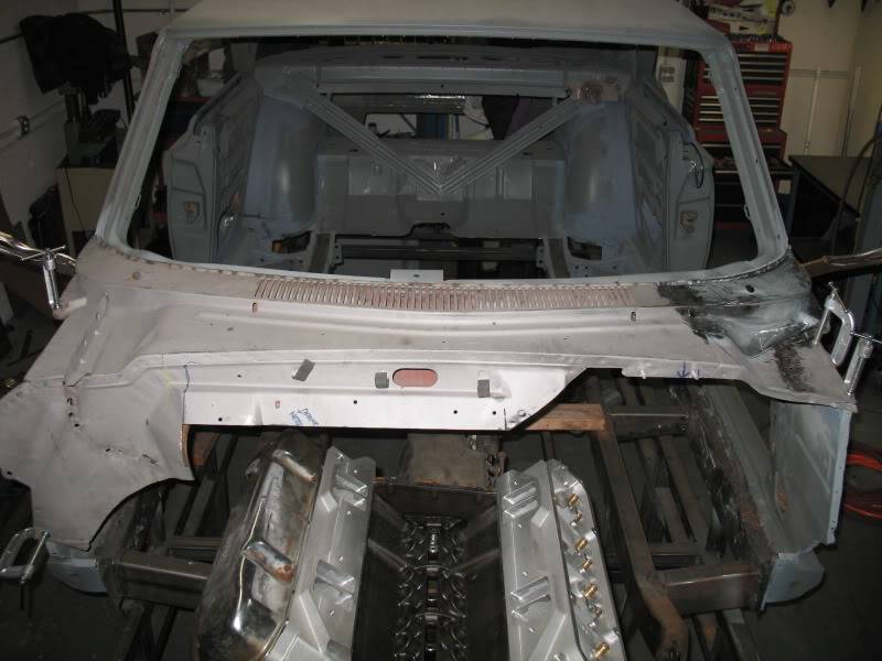

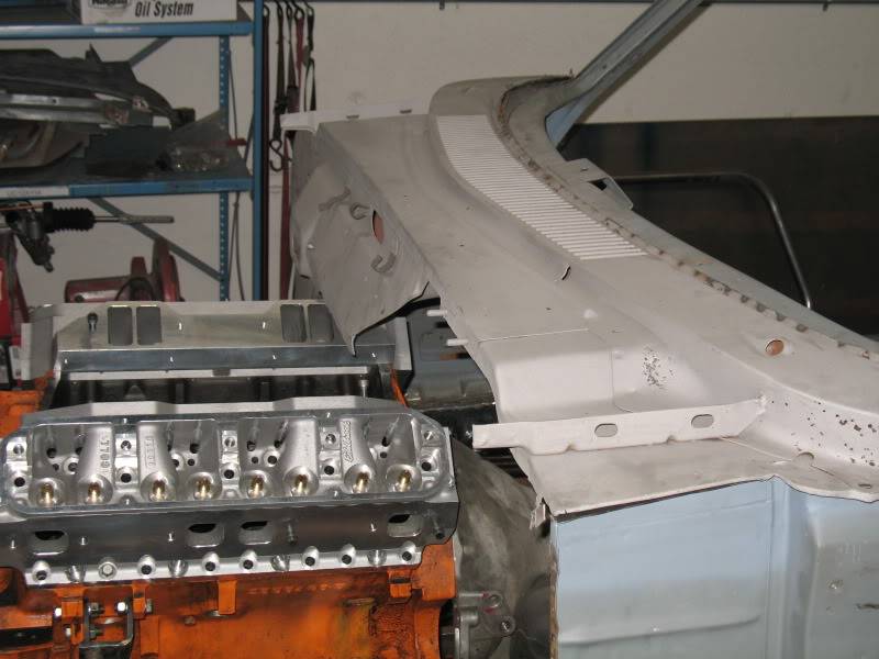

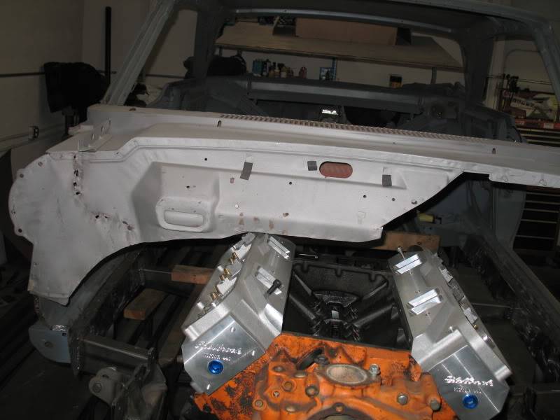

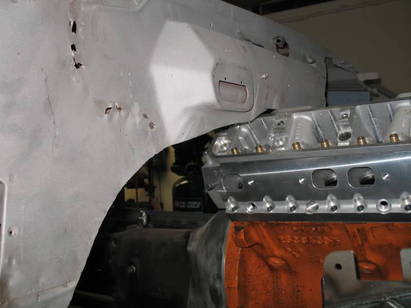

One thing I was uncertain about was how far our engine set-back REALLY was, what with the fact there was no cowl, no front sub-frame, no nothing to really gauge things from. Well, I guess pictures are worth a word or two because the pictures below pretty much tell the story: 50/50 weight distribution shouldn't be an issue, especially when you combine the set-back with the fiberglass hood, fenders, and bumper!
Yes, that's the original firewall sitting on top of the intake port for #8 cylinder:
Here's the view from the right side of the car:
And one from head on:
At this point I'm going to massage the replacement cowl and get it to line up nice and sweet, replace the rusted area with a patch panel (already have it), and begin to figure out WTF I'm going to do for a firewall. One idea, believe it or not, came from the Ring Brothers; they suggested using a wheel-barrow! Think about it, what a great contoured shape, it's heavy gauge steel, and if I can find the correct size it might just work, so I'm off to Lowe's to see what they have.

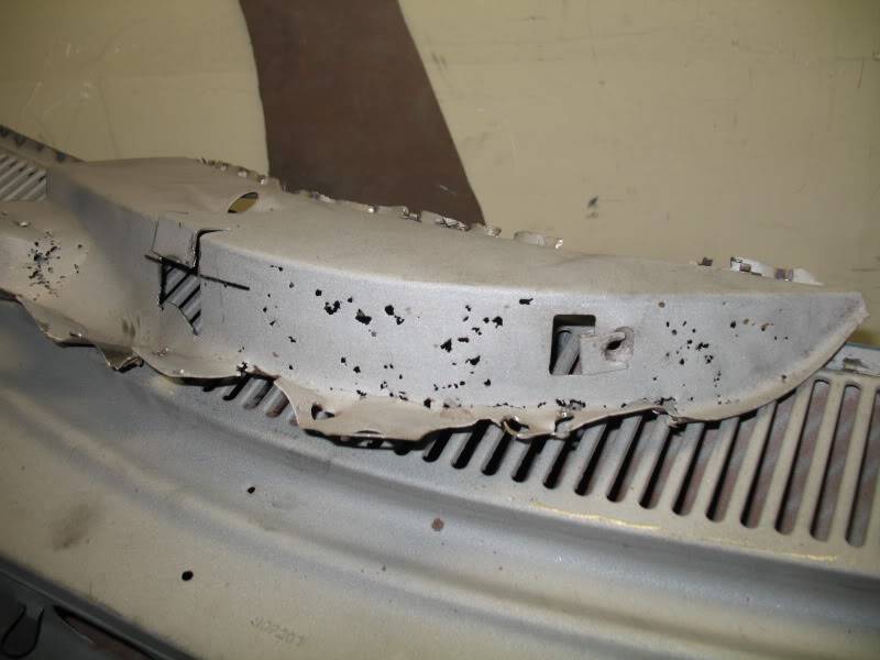

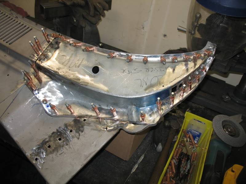

You know how in every job there's always some really necessary part that's boring, tedious, and downright crappy? Well that's been my life over the past week while I repaired the rotted end of the cowl. I knew I couldn't go any farther without the cowl and repairing it after installation would have been WAY more difficult, so I've spent the past week drilling, grinding, cutting, filing, and welding, all to end up with a mere shell of the cowl I started with.
Regardless of my whining the cowl repair really did come out pretty well and I'm happy with the results, so now I can begin working on getting it permanently installed then move on to the fire wall, doors, fenders, etc.
One thing this part of the project taught me was to lower the power setting of my welder as well as the wire speed: the spot welds came out fantastic by doing so. A lesson I won't forget going forward.
Well here are the shots of what I've been up to.
When I look back at my early posts I notice this part of the cowl looks exactly like the original, which is to say "F*#&#d Up"!

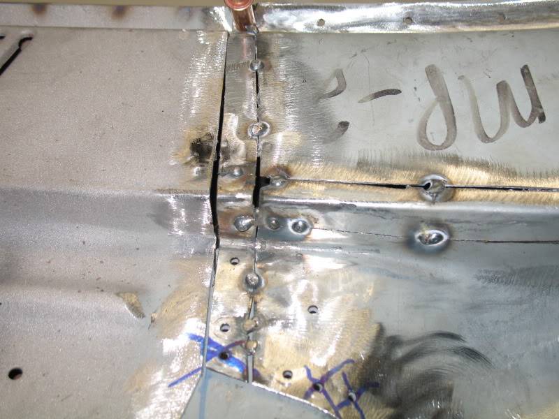

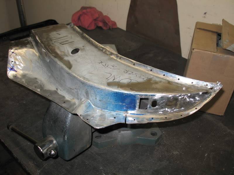

Not that I had any real expectations of the replacement sheet metal actually fitting well, and I wasn't disappointed: the replacement corner had to be cut apart like a pie then welded back to get it to fit:
Once I got done with all the cutting and splicing I ground down all the welds and cleaned up the repairs:
Then got busy with the Cleco's (got to be one of the best inventions EVER!) and welded it all together:
