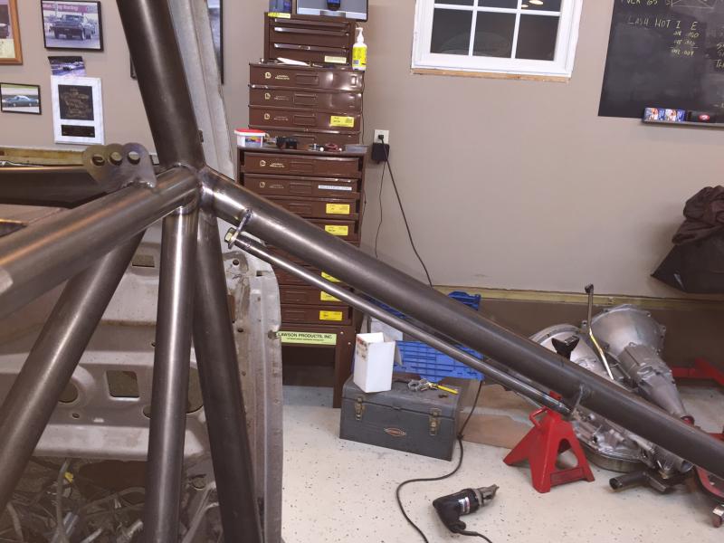

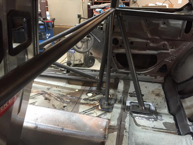

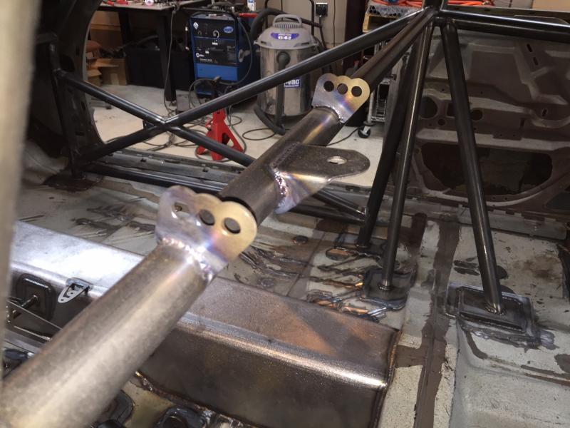

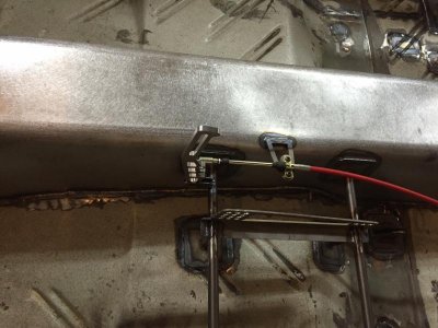

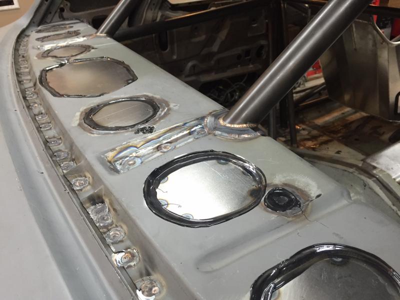

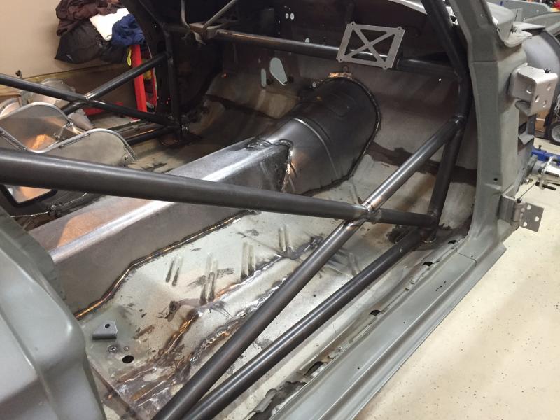

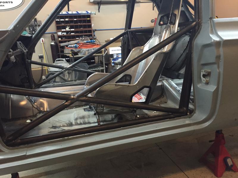

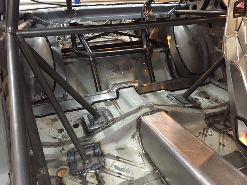

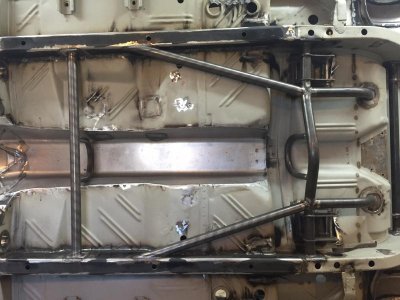

almost done with the chassis

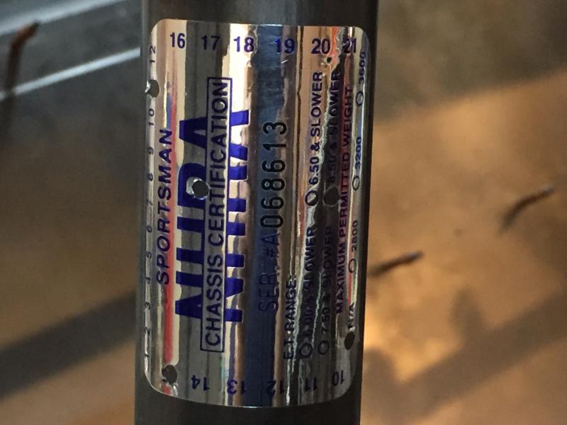

Just finishing up a few odds and ends, plugging some unwanted/needed holes and getting the door bars in. Have the NHRA inspector coming over to certify the car. Then off to media blast and then on to the body work for more winter fun.

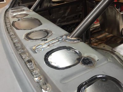

This build is an art work. Marvelous craftsmanship. Thanks for sharing the build.
We are shooting for 3300 lbs with driver race weight. Car will have steel doors and fenders glass hood, bumpers and trunk. Engin is a all auminum Hemi
All welds are TIG welded. My son loves to TIG weld!
I love TIG welding too. When I weld in my chassis ties, I'll TIG them in.
Are you sure your chassis will be strong enough? (!!:yes:!!)
Love your work Rick, beautiful to see!

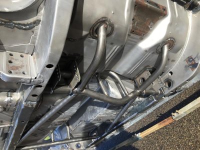

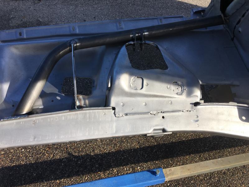

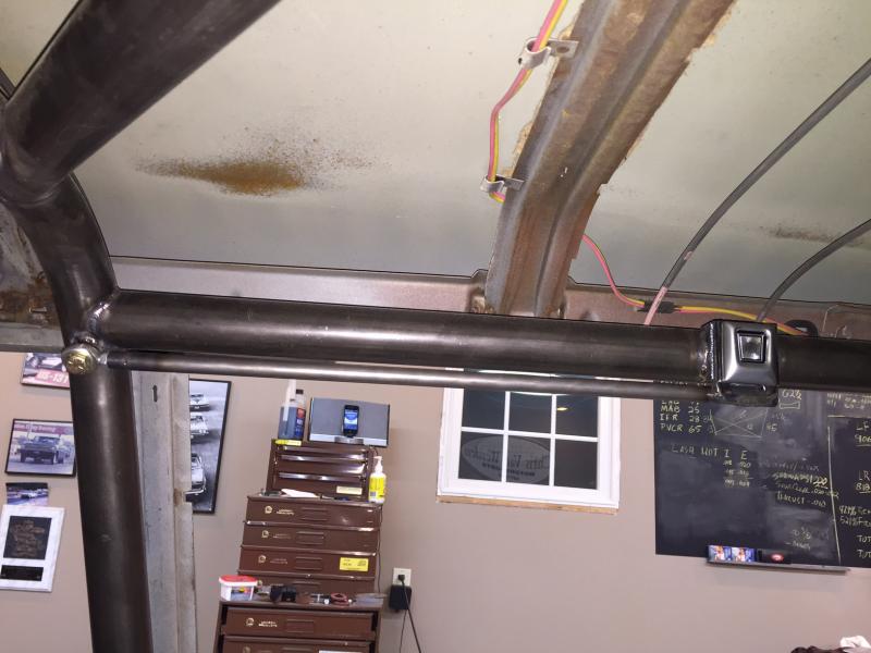

finished for now off to paint

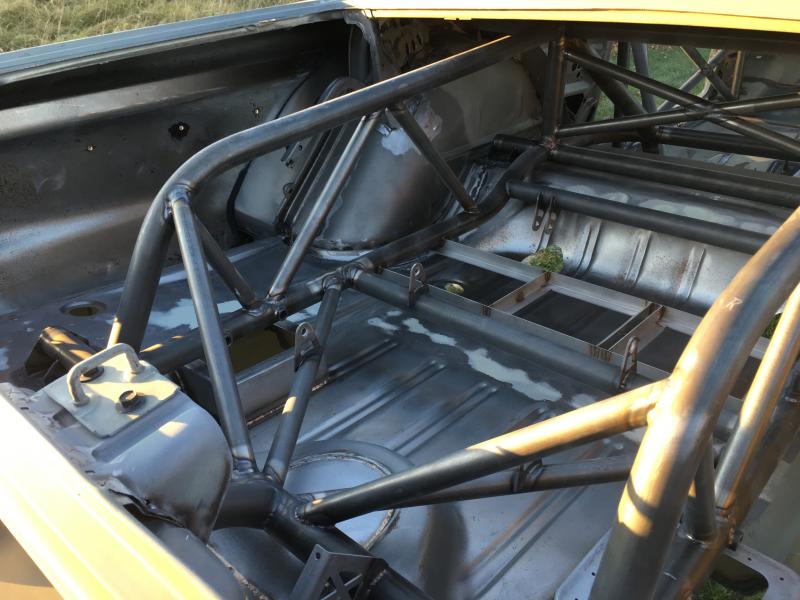

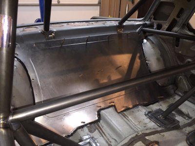

Just finished up a couple of odds and ends. Window net mount, seat belt mount, rear bulkhead panel and internal battery cut off switch.
The first trophy from NHRA

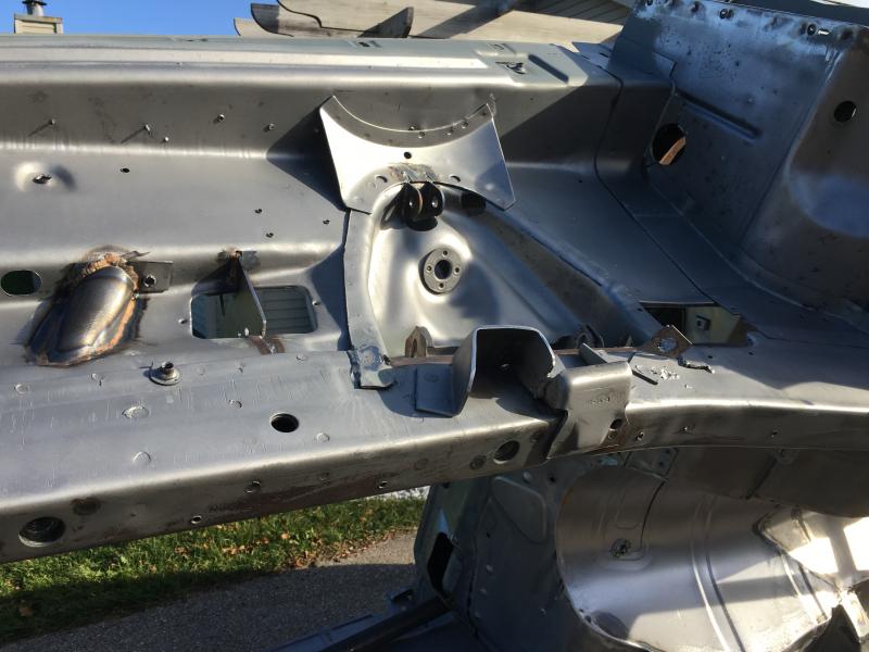

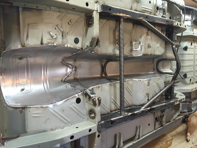

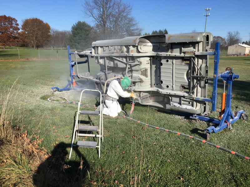

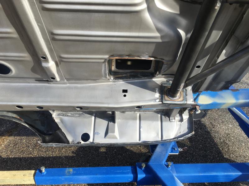

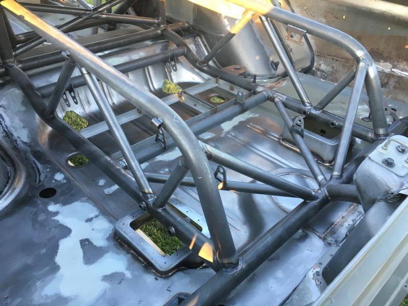

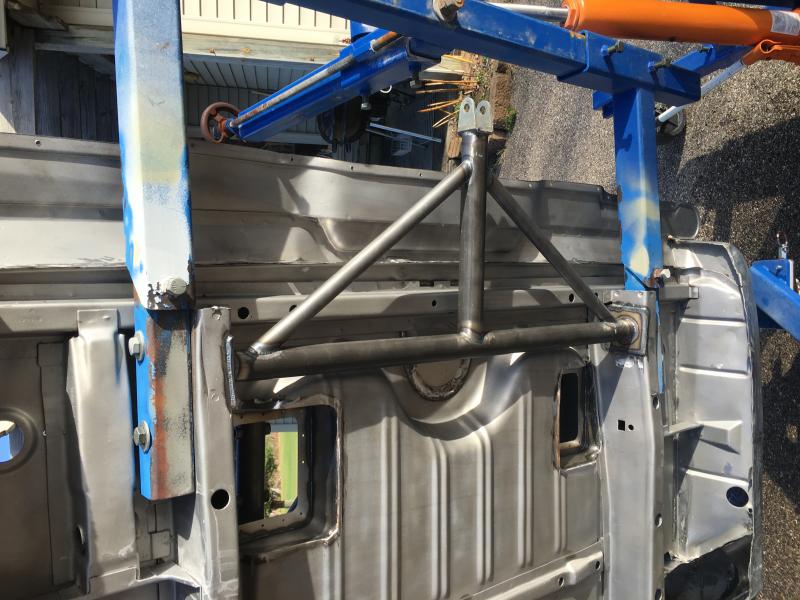

Soda blasted
Got the body soda blasted over the week end. This thing is solid. Thinking about just clear coating the bottom of the car. The car has all the original floor pans in great shape.

Clear coating the bottom would look sweet. Congrats on the cage certification. Looking great.
Yes I agree clear coat, would be a shame to cover that with a colour.
Not sure if I could teach you anything RVW but spend extra time blowing out the left over soda from all of the chassis ect, my first few passes at the track were very cloudy :) after a back to metal soda job.
TOP STUFF
The only problem would be if the clear coat got some chips. They would turn rusty pretty quick. Sure would look awesome though!
Missed a spot, lol!
Looking good!

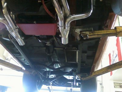

The trouble with clear coat is you can't seam seal the spot welded area's (factory frame rail to floor pan etc). Sooner or later it'll get moisture between the pieces causing rust stains. I spent a day seam sealing the bottom and wiping down the joints so it didn't show when painted. My Challenger was done the same way , 12 years ago, still looks fresh.
Doug
Good point Doug we have decided to go with the semi gloss black on the under side. The car is going to be Black exterior and red interior.
The SEM's hot rod black kit works awesome. Cleans well and is VERY durable. The other thing I should mention is with open headers the bottom gets dusty and sooty quick (even with proper jetting). I wash the bottom of mine 2-3 times a year.
