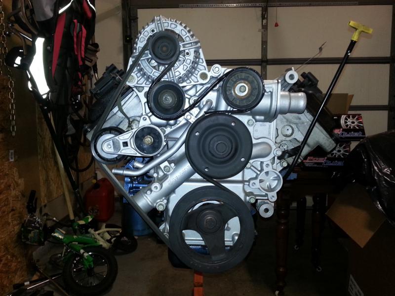

Like 5.7 says, use the truck timing cover if you can. It keeps the alternator up high on the engine and prevents the possible interferences with the frame rail. To avoid confusion from his picture, he made spacers to mount the car style manifold with the truck timing cover...that would not be your typical installation.
Here is mine with power steering and A/C deleted.
this image is just what i have been looking for. i now have a direction to go.

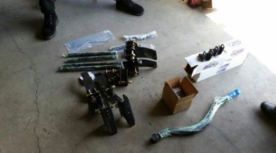

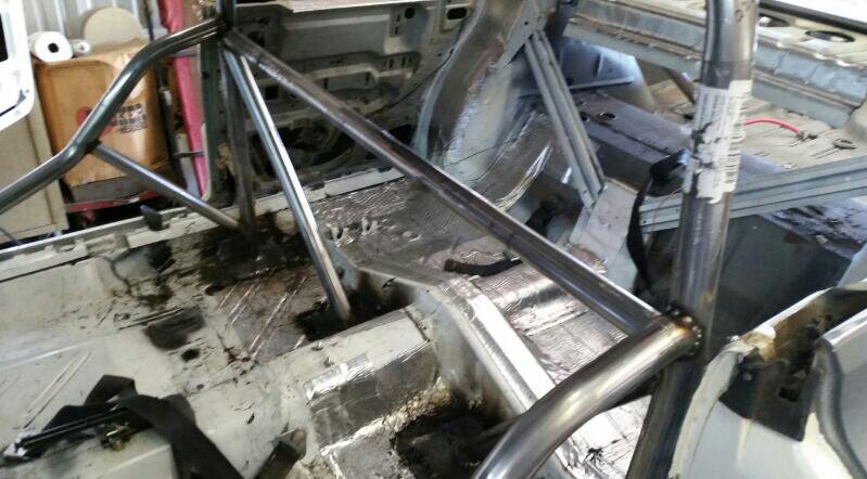

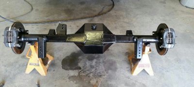

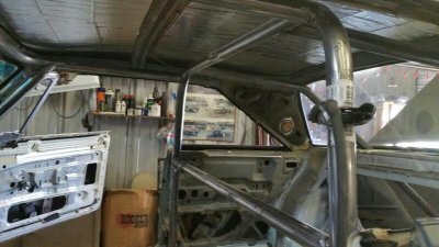

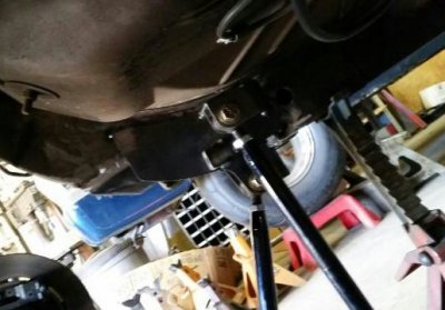

Cage is done. 4 link starts tomorrow
Posted via Topify on Android
Yeah, it is rock solid now. It should be zero flex in the body at all

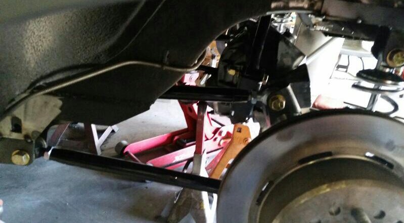

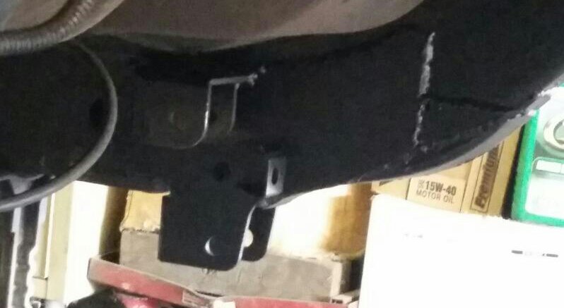

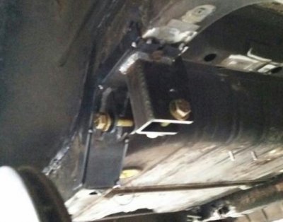

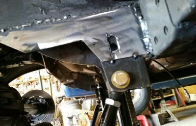

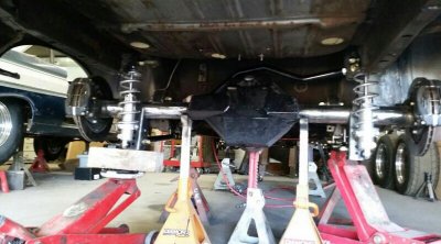

Suspension is coming together. Everything is roughed in and tacked. Time to set the ride height.

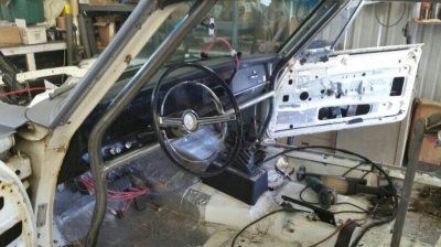

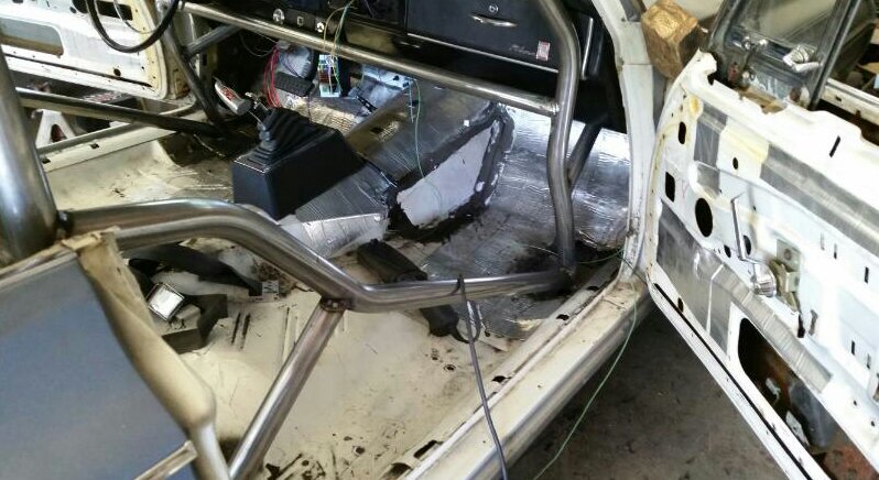

Just about done now
