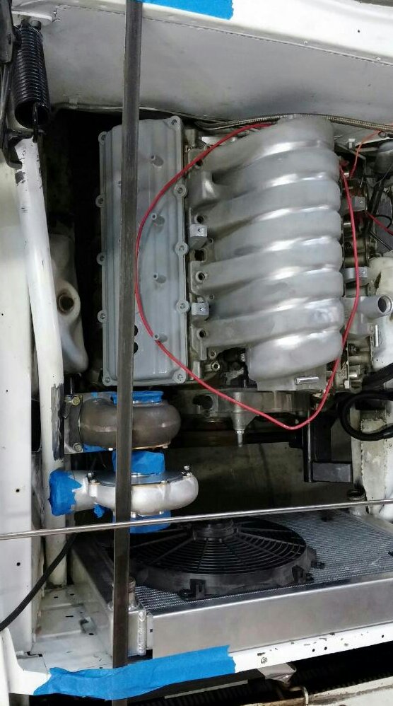

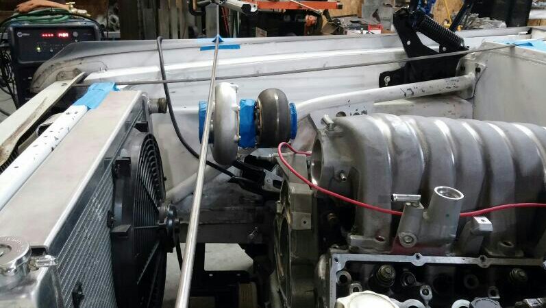

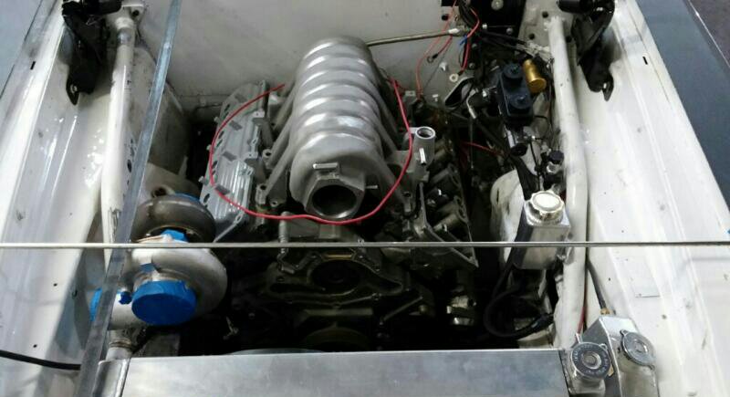

You'll probably need a heat shield for the turbo if its that close to the hood. But you probably know that.
Yup. All the hot side will be wrapped too. I decided to step up to the 88mm turbo.

How many pounds of boost do you plan to throw at it? Just out of curiousity with your build experience, what is a safe level of boost on a stock engine? 10 psi?
it varies. On a stock 6.1 about 7.5 with good tuning. On a 5.7 about 8-9. On a 5.7 VVT about 6.5. This motor is forged to the hilt, main studs, head studs, arp bolts.....I would say 16-18 PSI on C16 and probably 8-10 on pump gas. It should make 850-900 on pump and 1100ish on C16 with this bigger turbo. THat is wheel horsepower, not flywheel

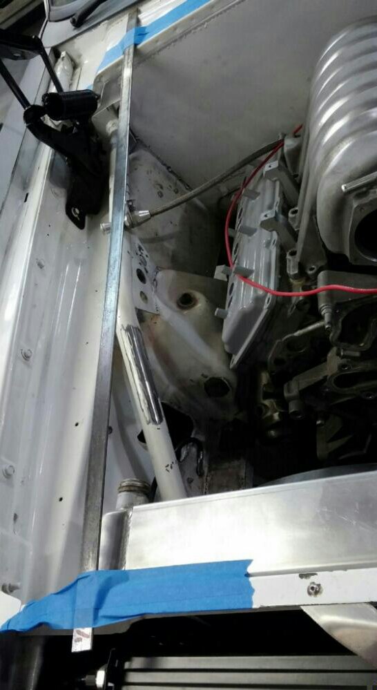

Is there a support for the turbo built into the inner fender bar? Kinda hard to tell.
It appears the turbo in the pics is a T4 housing. For the hp you're talking about, you'll need something bigger.
I'm skeptical of 1100rwhp at 18psi. That math may be a bit optimistic. Close, but not quite.
It just depends on intake charge temps. If I can get the charge temps way down and run some good gas, and the timing holds, the sky is the limit. Whatever the big number is will just be for show anyway. I plan on turning it down to about 800 wheel horsepower for driving on the street. The only time it will be on kill is when I go for the ET runs or the texas mile. I will put a 7# spring in it and control the boost with C02 on the backside of the gate.
There is a support. Those pics are the first fab attempt. A much wider and strong bracket is already on there as we have picked the final turbo placement now. I will post pics in the next week or so as week make progress

What turbo have you decided on? Compressor map?

as far as the turbo, its a comp 433600-0014 88/79 1.15 AR. I didnt see compressor maps on their site. We talked to the guys at comp before deciding on this turbo. It should be in the sweet spot of the map. As far as the ideal gas law comment, charge temps are a result of pressure and volume. The style of exhaust, efficiency of the turbo or the compressor map, and cam selection all play a role in those things. There is intake charge temp and cylinder charge temp to consider. The quality of the intake, heads, and camshaft profile all playing a major role in resulting cylinder charge temp. The lower the intake charge temp, the lower the the cylinder charge temp starting point. Then it becomes a question of valve timing, overlap etc to determine the resulting cylinder charge temp. Probably pretty simple stuff for someone like you and me, but I bet we just lost some folks
