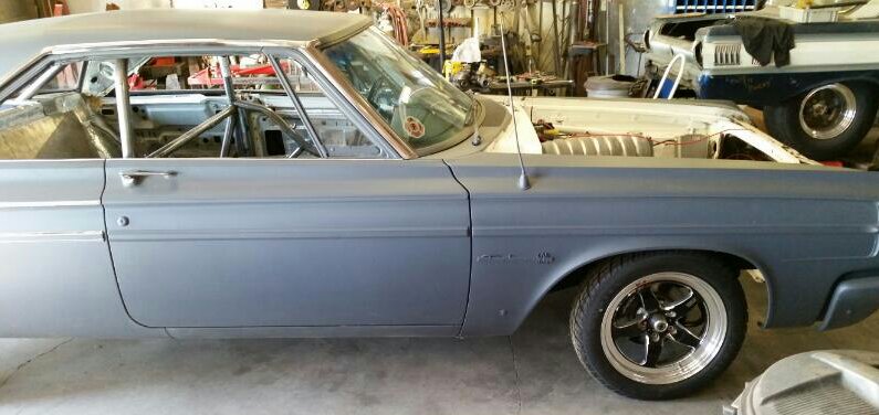

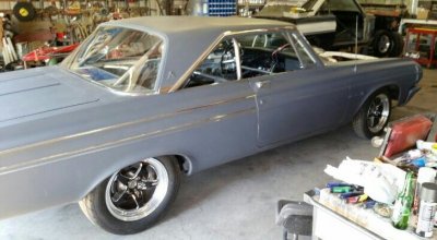

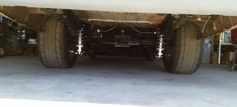

Here is my latest update.
Rear suspension done
Cage done
Rear firewall done
I'm going to drop it a couple more inches all the way around. But other than sway bars....the chassis is completely done
Posted via Topify on Android

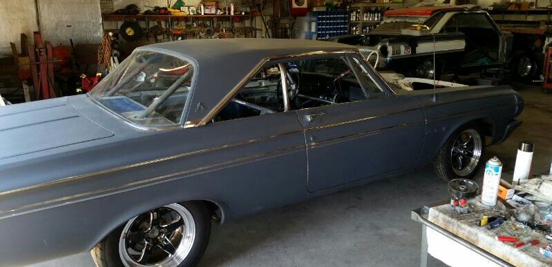

Off to SNL Performance in Fort Worth for the turbo fab next.
