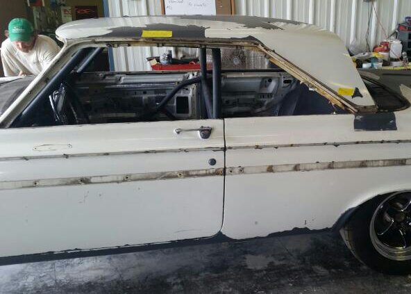

Well the car is stripped and it's been at the painter a couple weeks now. Found a little rust around the window trim, but still an extremely solid car. We will fix it all. Cars getting painted a new viper blue.

Get them door handles and key locks off the doors.....I thought I taught you better than that, lol!!!
He told me to leave em for now. I will get out there and do it when he asks me to

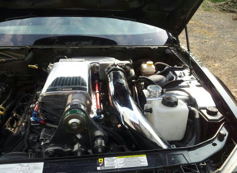

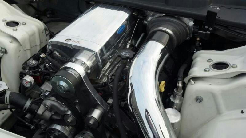

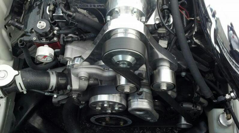

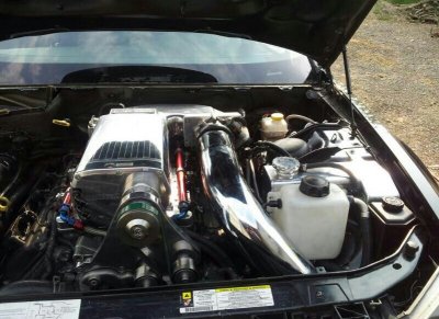

Turbo project went astray. Found an insane deal on a 4.2L kenne bell supercharger. Shouldn't have to push it too hard to make my power goals.

It's not going to run outta huff. That's for sure!

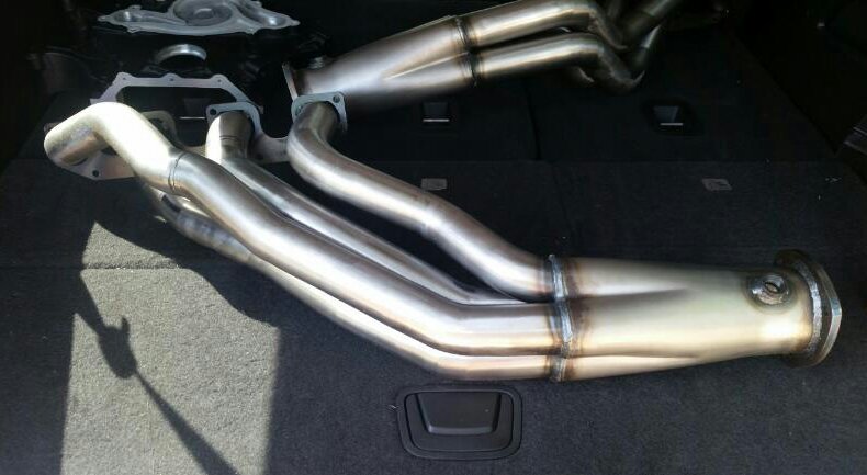

Headers finally showed up after more than 2 months of waiting. Tti 2 inch primaries to a 3 inch merge collector.
Headed out to get them black ceramic coated.

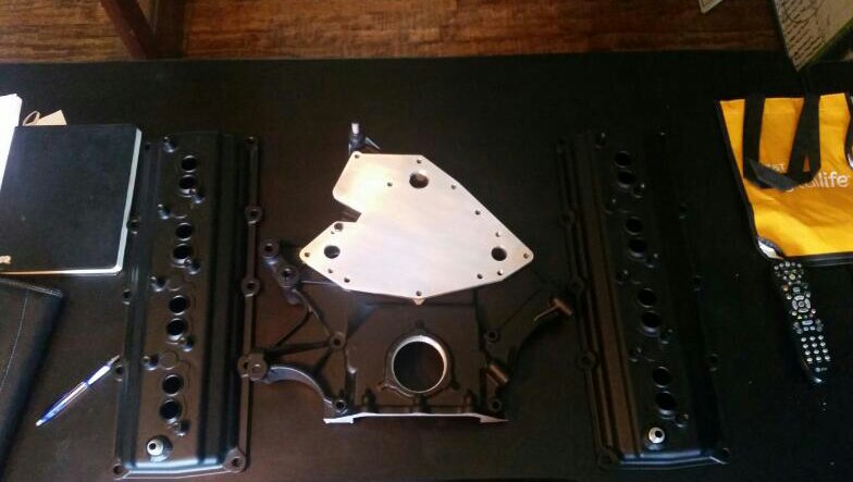

I got the valve covers and timing cover back today. The came out great.
Posted via Topify on Android

Sometimes I feel like nothing I do with this build works out. So the 4.2 KB will not fit. I would have to cut up the firewall again and they it still may get into the wiper motor. So the 4.2 is completely out of the question.
